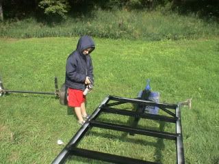

Have made some progress, bought plywood, put frame together and painted, I think I am going to go through it and replace all of the nylock nuts, becasue I welded the seams and I know I fried the nylon out of at least one nut.
Here is a pic of my nephew helping paint the frame.
He was sweating in the 90 degree weather but the instructions on the can said 2 light coats are better than one heavy coat.
By the way I thnik I have lost this TD, because he is already calling it his, and is asking me where I will sleep.

Postby bve » Mon Jul 13, 2009 6:41 pm
Aaron Coffee wrote:...
I guess you get the tent :lol:

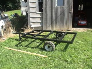

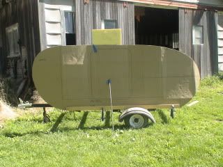

Postby Aaron Coffee » Sun Jul 19, 2009 12:26 pm
got the frame finished
And my first attempt at a profile
Any suggestions, thoughts, other than the door needs moved forward.

Postby kennyrayandersen » Sun Jul 19, 2009 5:17 pm
Aaron Coffee wrote:got the frame finished
Went shopping yesterday, and bought the boards to put between the floor and the frame, got home and realized I had bought oak, oh well. Think I found some 1/8 real wood paneling for roof. Will still look around for 1/8 ply though. And found Cabots Spar Varnish, which leads me to another question, Is Cabot's a good choice, and if so is $35 a gallon good or bad or average?
Thanks
The full return curve in the back (especially the bottom) may complicate your hatch build. You might want to go a little away from the spud shape and make it a little more teardrop shaped in the back -- that would help. :thumbsup:

Postby Aaron Coffee » Sun Jul 19, 2009 7:36 pm
The hatch will only be a half hatch coming down to the contertop, the lower portion will be enclosed with acces lids in the countertop. Have one of the engineers at work doing some cub drawings for me with verticle and horizontal point measurements, just tried to freehand a profile. I think it needs more curve in the top, like somebody here said cardboard is cheap, I can get 5x10 sheets of cardboard for free.

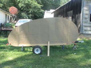

Postby Aaron Coffee » Wed Jul 22, 2009 4:31 pm
Here is my second and final(?) profile, I was able to use turbo cad and shorten the cub profile in the design library, it is now 107" long and 43 1/2 tall, was aiming for 108 x 42, but what I came up with is close enough for me. Think the door could move towards the back six inchs or so.
Have to get a router bit to join the plywood then I am ready to start making sawdust!

Postby kennyrayandersen » Wed Jul 22, 2009 5:28 pm
Aaron Coffee wrote:Here is my second and final(?) profile, I was able to use turbo cad and shorten the cub profile in the design library, it is now 107" long and 43 1/2 tall, was aiming for 108 x 42, but what I came up with is close enough for me. Think the door could move towards the back six inchs or so.
Nice! Much better than the 'spud' above :lol:
