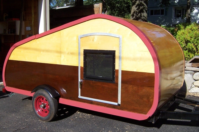

I am a woodworker, and had some thick,(1/8") Walnut veneer sitting around the shop, had used most of my supply on folding tables for family get togethers. When I was deciding on the woody, went with that on the bottom and Baltic Birch up top, laminated it to a sheet of 1/8" Luan, then CPES, 5 coats of Spar afterwards.
Image[/img]
