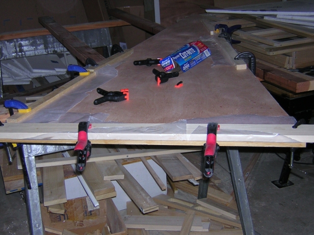

You can get by with less clamps if you can clamp a board down on top of what you want to clamp. That way, you only need half a dozen where you might have needed a dozen; or, 3 were you would have needed 6. So far, I've gotten by with about 22, give or take (a couple cheap ones broke); plus, I borrowed two pipe clamps. Here's an example, using boards with clamps:
(The waxed paper prevents sticking things together that aren't supposed to stick. Buy about 3 rolls of that!) Curves take the most clamps, for obvious reasons. Also, I saved my 1 gallon milk jugs (screw top) and refilled them with water. The jugs aren't enough by themselves but can be used as fill-ins for added weight in middle areas. If you're building a curved roof TTT or Teardrop, ratchet straps could be useful, too. :thumbsup:
