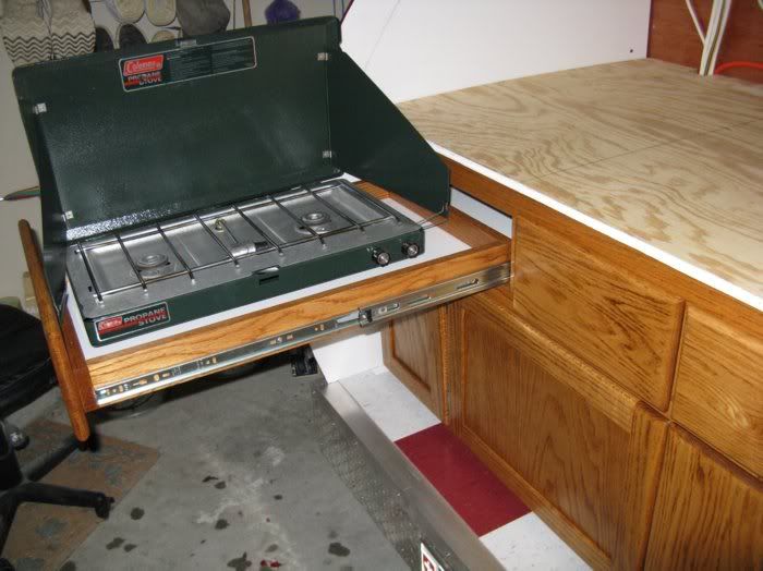

TENNJIM wrote:
doug hodder wrote:I've got Coleman white gas stoves and drill the foot bumps on it and through bolt it with a wing nut...makes it removeable. You'd want to make sure that there is an air gap under your stove. Doug
I did the same thing with a Coleman propane stove. Mounted it to a slide-out from my galley.
8)
Jim B / Utah

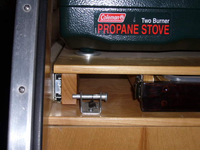

How do you keep the sliders locked out to prevent a lit stove from rolling under the counter top?
Ignorant doesn't know any better, Stupid knows better but does it anyway.

Postby TENNJIM » Wed Apr 14, 2010 2:25 pm
The Slideout Latch holds the shelf in when traveling. Open the latch, slide the shelf out, slide the latch-pin into place behind the shelf to keep it from sliding back in. Works great.
