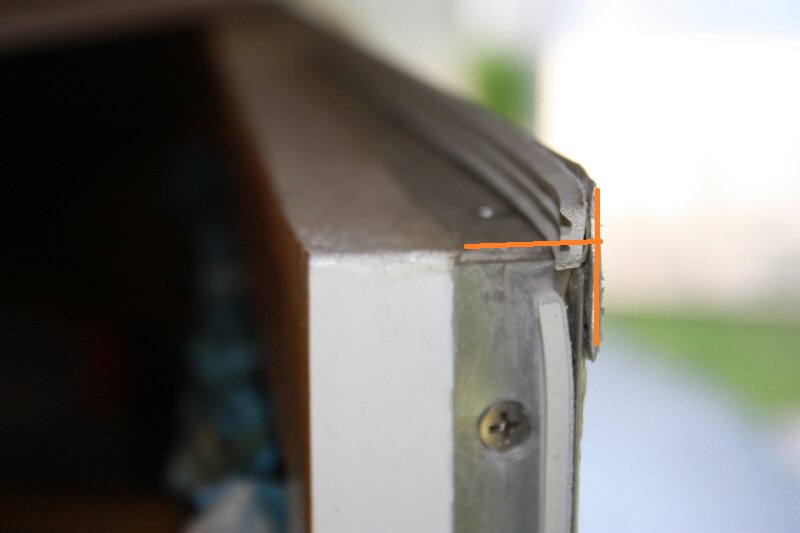

steve smoot wrote:Mike, sorry but this old boy ain't getting the idea of the T mold on your door. I always thought T mold is fitted into a grove and used to cap the edge of something.
It looks like you have part of the T mold covering the door opening when the door is shut. :thinking:
Steve
Steve, no slots in this application. Just set it on top of the door and screw it in. here's a couple pics to make it more clear...

Postby dh » Wed May 19, 2010 7:22 pm
Steve
Yup, the "tang" on the tee wraps around the edge of the door, the "flats", well, one sits on the face of the door, and the other extends past the face of the door, and gets the weather stripping. This is where the off set hinge comes in, so there is clearance for the weather striping.

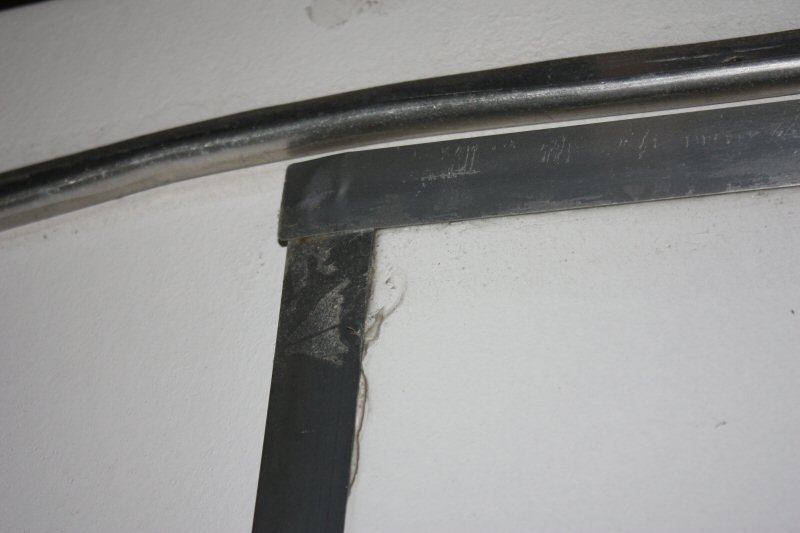

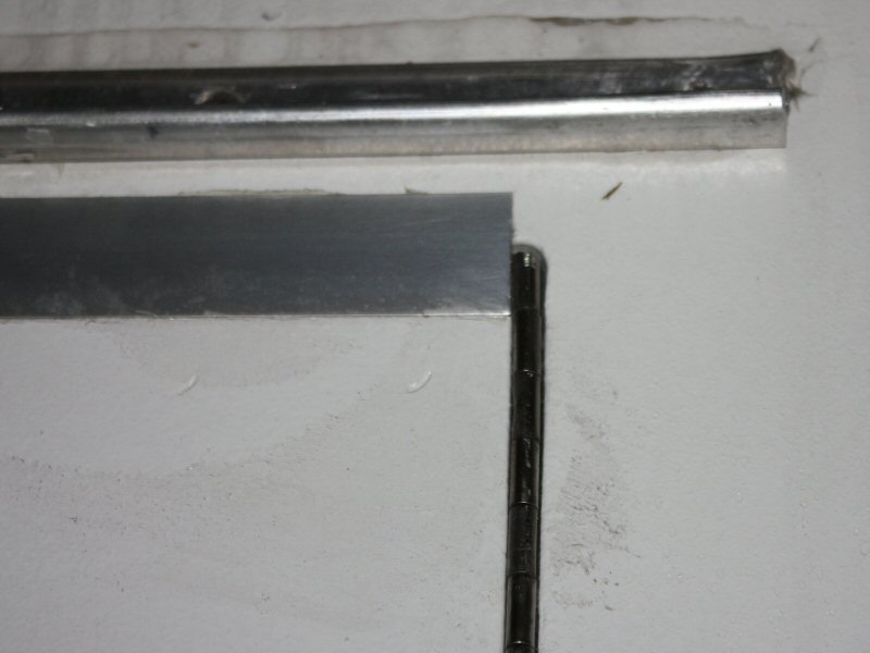

Mike, do you have a picture of the front top corner of the door, where the vertical and horizontal T-molding come together? Looks like you just overlapped them. This would greatly simplify my plan of mitering the T-molding.

Postby mikeschn » Thu May 20, 2010 8:01 pm
dh wrote:Mike, do you have a picture of the front top corner of the door, where the vertical and horizontal T-molding come together? Looks like you just overlapped them. This would greatly simplify my plan of mitering the T-molding.
There is no vertical molding on the front of the door. There is in the rear. and yes I overlapped them.
I'll take more pictures tomorrow when it's light out.
Postby dh » Thu May 20, 2010 8:37 pm
Now you really have me scratching my head. Or are we talking about two different things? I was wanting to see what the molding looks like on the door face.

Postby mikeschn » Sat May 22, 2010 6:11 am
Here is a picture of the door front
Here is a picture of the door rear
Postby dh » Mon May 24, 2010 8:03 pm
mikeschn wrote:Here is a picture of the door front
Thanks mike, that helps alot. :thumbsup:
