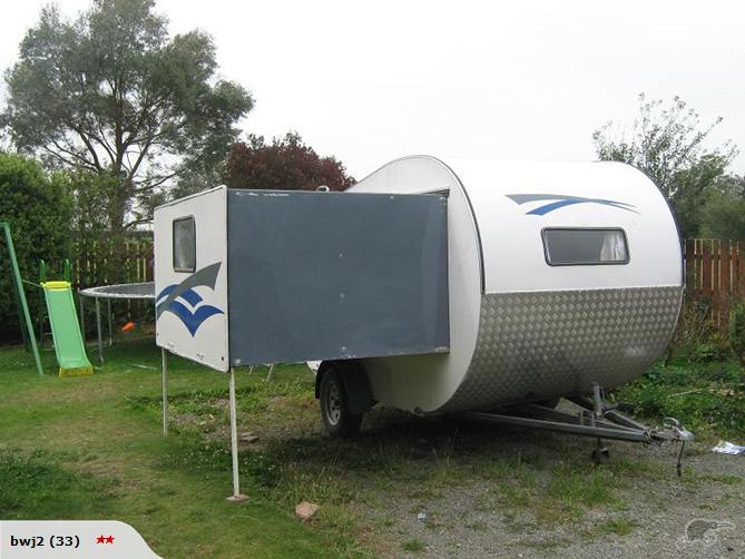

Postby mezmo » Sat Feb 12, 2011 10:27 pm
Hi Kevin & Sandy,
This is more of a slideout than you were mentioning but I'd
think building a larger one can't be much more work than a
small one.
There are more pics of it in my Album.
I'm guessing it may be a 5wide.
It's a homebuilt that looks to be halfway between a TD and a TTT.
[It's from the New Zealand Auction Site " Trade Me...".]
