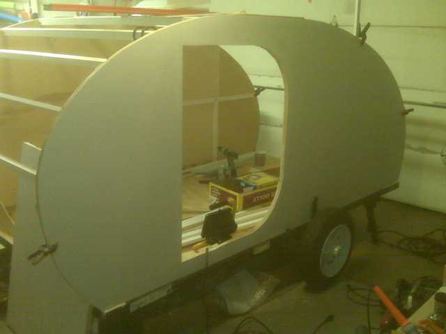

The only joint I have at the moment is directly above and below the door hinge line. Its just a few inches above and below the hinge. I did that on purpose to keep the joint as small as possible. I got a piece of that channel you are talking about but probably won't use it since the join line is so small. If I decide to use the FRP on the roof then I plan to cover any joints with putty tape and flat aluminum trim from the hardware store. Should match up pretty well with the aluminum edge trim at the roof/wall line. I don't trust the plastic channel and figure it would go brittle in no time from the UV exposure.
In the picture below you can see what I am talking about. The only joint I have is at the door hinge line.
