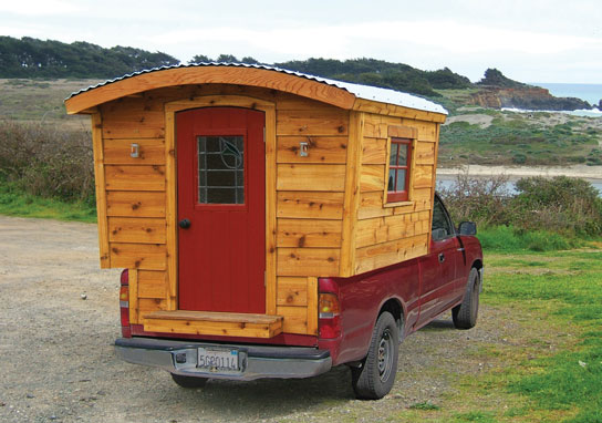

Well Im going to be useing 1/4" exterior plywood on the roof. Im going to try doing my roof similar to the pic Image Now I saw at lowes they sell the precut "wavey" lumber to set in the front and back side of the roof, but the low fill spray foam is a great idea to help fill the gaps. Im hopeing if I calk the "wavey" wood after screwing it down might help keep out the driving rain You know far more about this then me. Would the roofing felt cut down on the sound when its raining outside? Where can I buy the ice membrane? Is it a HD/Lowes kind of product?
