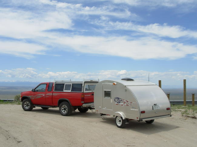

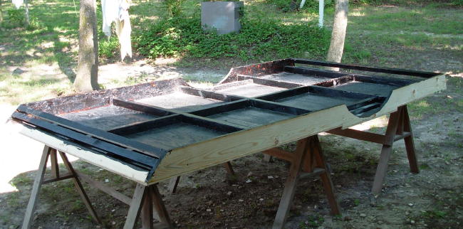

My 60" by 114" TD cabin was built on an HF 4x8' trailer (I did modify the tongue). My floor/base was built of ripped 2x4 with 1x6 side rails. Have had absolutely no flex or 'give' in any of the overhang & it pretty well survived a rear end collision that really mangled my little 'decorative' bumper. Construction pix from start to finish+ in my album -
frame getting ready to attach 'floor skin'
frame floored & undercoated before insulating
base/floor ready to start cabin construction - note the 'wheel wells' intrude only about 1 1/2" vertically into the cabin
used it like this for first 6mos

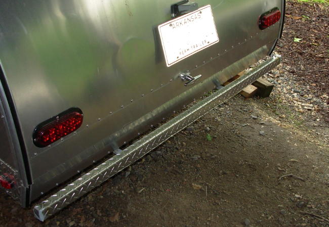

bumper? tongue box? all on the original 4x8 HF trailer
been towed 12K+ miles like this
