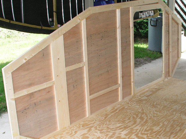

This summer I played with biscuit joints in plywood. Below is a picture of what I used biscuit joints on... The walls are plenty strong as long as you are careful moving them. I would not apply any real pressure on the joints until I have the 5.2mm luan glued on both sides of that joint. ;)

mikeschn wrote:This summer I played with biscuit joints in plywood. Below is a picture of what I used biscuit joints on... The walls are plenty strong as long as you are careful moving them. I would not apply any real pressure on the joints until I have the 5.2mm luan glued on both sides of that joint. ;)
Now that I have the biscuit joiner, I'll probably use it on my framing pieces (spruce) as I glue and screw them to the outside skin (1/4" or 5.2mm Luan). As it is, I'll have 2 full length vertical framing pieces for backing the joints of the three plywood skin pieces and one full length horizontal framing piece on each side (except for door cutout), which I'll lap joint with the verticals. The other pieces I can biscuit join where needed. That should make for a pretty stable side wall.

Postby mikeschn » Sun Oct 09, 2005 3:38 pm
cracker39 wrote: which I'll lap joint with the verticals. The other pieces I can biscuit join where needed. That should make for a pretty stable side wall.
Sounds plenty strong to me...
My weekender walls were only butt glued, and it was surprisingly strong...

I plan on building my framing out of one piece of 3/4 plywood and cutting all the material away that doesn't look like framework. :lol: That would be a whole lot easier than fastening all those joints. That's how Mike has done it and it sure makes sense to me. But I am going to have to join two sheets together because I need more than 48" in height.
