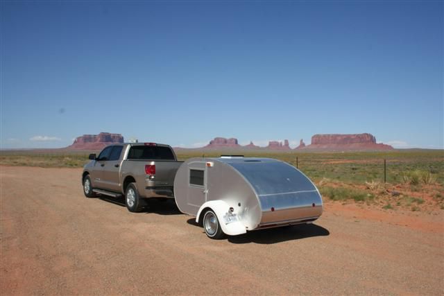

Dale M. wrote:Technically your marker (clearance) lamps are wrong.... They are not supposed to be mounted at frame level but at upper most section of trailer body.... The only reason the are on frame level with HF trailers is because at time of sale and to have legal lighting the frame is highest portion of trailer....
BUT I seriously double an enforcement officer will take issue with where they are mounted....
Dale
Thanks Dale for the information. I was going by the information on the NHTSA site. It says that Front Side Marker Lights needed to be mounted on "Each side at front - as far forward as practicable". As for the height, it said 15 inch minimum from the ground. As far as I can tell, my trailer meets these minimum requirements. Here is the link to the site:
http://www.nhtsa.gov/cars/rules/standards/conspicuity/trlrpstr.html
Tim

On the sides; Orange at the bottom of the front arc, Red at the bottom of the rear arc. Stop/turn on the fenders. I wasn't totally satisfied with the ones on the fenders because you only see one unless you're directly behind so I added another pair under the bottom of the hatch opening Hard to see when not lit up. Finally I put a pair of reflectors on the rear.
