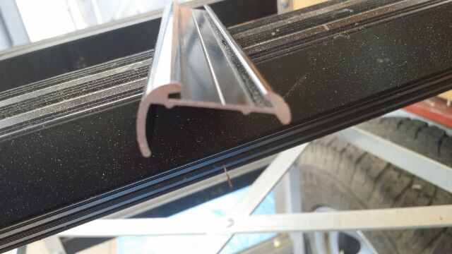

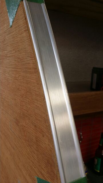

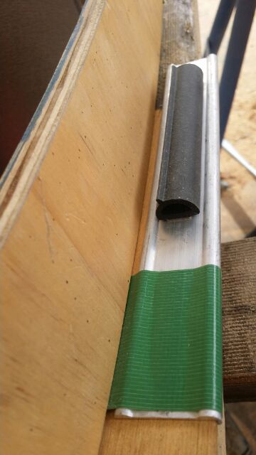

Postby dales133 » Sat Sep 05, 2015 9:11 pm
Ok heres some pics of the componants ive found to make the seal/edge.
I may need to change the underside if the hatch to .5 mm aluminium as the piece ive got tbere now may restrict coverage by the edge mold
dales133
