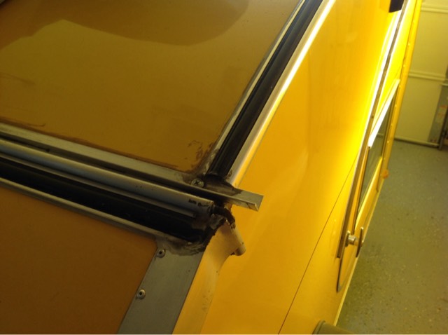

Hatch edge leaks-need advise please

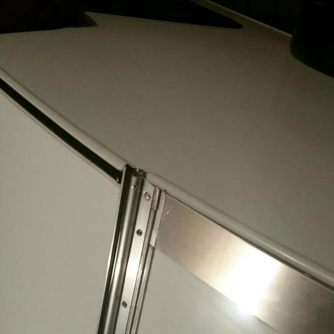

Postby dmdc411 » Wed Nov 25, 2015 11:24 pm
I installed a 3" wide strip up the sides and across the bottom of the hatch. The 3" strip is attached with angle clips to the frame. The 3 inch strips lay over the exterior walls. The edge of the wall under the lift gate is covered with the same edging as the exterior roof to side wall trim. I didn't put the black cover over this portion, but I used a round bulb seal that come with double backed tape that is attached to the door and closes inside the channel of the trim. Haven't been in the rain yet, but I'm sure it'll work.
