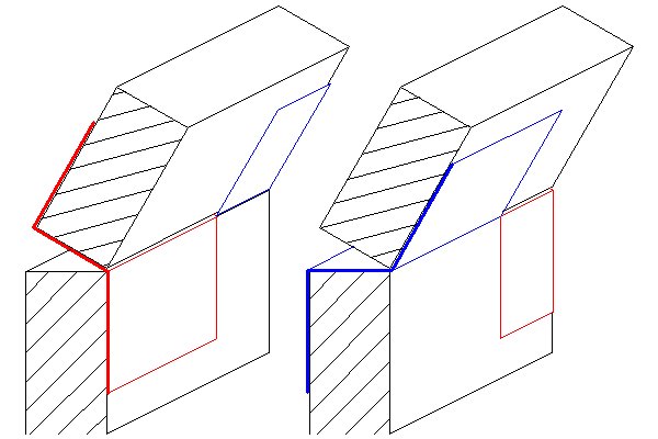

It would be convenient if the folding joints between the panels would fold both ways (so the three-panel assembly can be folded up in a 'Z' shape) and they need to be very low stress - I don't think I could come up with a way of sticking piano hinge on the foam, as the hinge would just snap off, taking a little bit of foam with it.
I suggest the old-fashioned fabric hinge - this folds both ways, is super light and spreads its load over as large an area as you like. This is also exactly the sort of hinge that used to be used on movable draught/privacy screens just like Bledsoe posted.
It is made from, say, 3" wide strips of material that are stuck onto the opposite sides of adjacent panels over a length of, say, 3". Next to the first strip is another strip stuck the other way around. This diagram (looking down from on top) shows the first strip on the left in red and the second on the right in blue:
You could even make the hinge out of duct tape alone, although you would have to carefully stick two pieces of tape sticky-face-to-sticky-face (that's not going to line up every time, is it?) with the overlap in the middle of the joint - you can't use one piece of tape as it has to stick on opposite sides of itself to the two panels.
