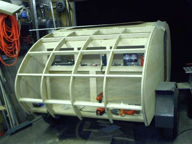

You might try clamping the hatch down while the glue for the skin dries. I pulled the top and bottom of the the hatch together about a 1/2" while it was drying and had minimal springback. My hatch will try and straighten out if I leave it open a long time (like all week in the garage). I have draw latches on the side to pull it in when closed and it goes back to the proper shape after a day or two. Not shown in the picture is the pipe clamp I used to pull it into a tighter radius.

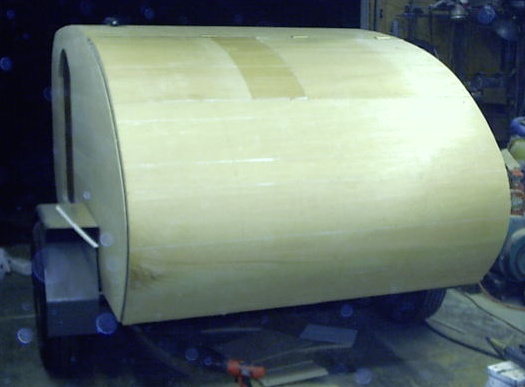

I didn't read all the post but I did read the first one and what Grant had to say, and a couple others. And like Grant says, you don't need to skin with 1/4" ply. Your just going to have problems. The way I built mine was locating the frame work (3/4" birch ply and the trim was matched to the sides, no spring back figured in) to the tear and then I located the outside skin (1/8"birch ply) with about 6 screws and then took it to the bench and applied all the rest of the screws. After that was finished I laid it in place and wala, it fit and matched the contour perfect. The bottom pic is of the hatch just laying in place with no clamps or anything else to hold it in place. Looks pretty good. Several months later I removed the hatch from the tear, laid it on the work bench and clamped another sheet of 1/8" birch ply to the interior. Added glue and more clamps and I was finished with the hatch. And still no spring back. It was no harder building my hatch than it was building the complete teardrop, mater of fact it was easier. It's just the way I did it. I'm not saying it's the way you should do it.
