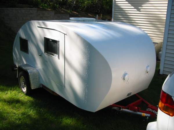

Postby Arne » Wed Apr 29, 2009 1:54 pm
I have sanded my tear and applied blue water top deck paint to it... a one part polyurethane. the high gloss white. will post pix later.
Painting with house paint was a mistake.. it got dirty way too much.
The marine paint is high gloss. I am writing this mainly to save others a pain of using house paint... go for a marine paint instead. Sanding and repainting is a pain... had to mask the windows and other exterior hardware, which was not removable...
It came out good for using a roller over ply.. not a good as over fiberglass...
My opinion, spend the extra money from the get go, and save yourself a lot of dirty paint and problems.... The marine paint is tough stuff.... and I recommend it over rot doc uniflex 255, which got dirty and was impossible to clean...

Postby Arne » Sat May 09, 2009 6:04 pm
paint is dry, new lights installed.... heading to lexington, KY tomorrow a.m.

Postby High Desert » Sat May 09, 2009 6:06 pm
looks really nice Arne! :applause: :applause:

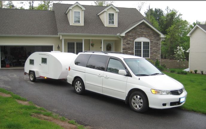

Postby Arne » Sun May 10, 2009 6:45 am
I only pulled it about 20 miles yesterday, it got a few smudges/dirt marks on it...they wiped off.... with the house paint, they might have washed off...
And I like the high gloss finish much better. much closer to the gloss on my van than the house paint was.
I doubt I will get much stone damage. the front of the trailer, by design, is only 24" from the back of the van, just enough to get the van back lid up. If I had measured better, I could have made it 18" and cut the air turbulence between the van and trailer even more.
And when I turn the tightest circle I can with the van, I still have 8" of clearance between the van and the front corner of the trailer, partially due to the curved front on the trailer.

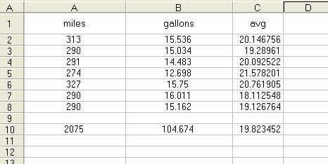

Postby Arne » Tue May 19, 2009 4:10 pm
gas mileage for trip from ct to ky and return.... first and last tank not included.

Postby Arne » Tue May 19, 2009 4:11 pm
when I drive locally, I avg 20-21 mpg.... on the highway, 22-23.... I specifically drove the northern route to avoid the hill in w. va....

Postby S. Heisley » Tue May 19, 2009 7:33 pm
It looks really good, Arnie. It looks like it matches your minivan exactly!
Glad you had a good trip. :applause:
