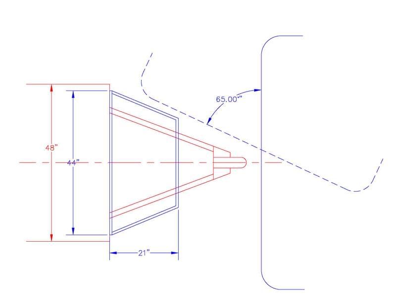

I went to HF and viewed the PDF of the 48"x96" folding trailer, and it is the way Andrew drew it... (say that 5 times fast)...
http://www.harborfreight.com/manuals/90000-90999/90154.pdf
Is this what you are wanting Ira, same width, and depth?
Mk

Postby Ira » Wed Oct 25, 2006 1:34 pm
I'M IMPRESSED, MARY!
(Watch out Andrew--you have a little compettion.)
But where did you come up with that 21" depth? I just eyeballed it when I BUILT the thing, and I don't know the actual depth myself!
Plus, what would the length of the sides be, because that can't be the same 21, right? Or that measurement is so close to that that it doesn't matter anyway, right? An inch either way?
Finally, explain this to an idiot like me:
Your picture shows me overhanging the rails by a lot. This is totally throwing me off since Andrew's drawing doesn't on one side.
I told you I'm pitiful, which Andrew already knows, However, you've been here long enough to know this as well. I sure hope my kids don't inherit THESE genes of mine.
In other words, if I get the lengths of those side walls from you, and overhang it, I should be fine with that 65% swing?

Postby Mary K » Wed Oct 25, 2006 2:04 pm
Ira wrote:But where did you come up with that 21" depth? I just eyeballed it when I BUILT the thing, and I don't know the actual depth myself!
Andrew mentioned it in his first reply, I assumed it meant 21" depth, from front to back of box...???
It can be what ever you want it to be.
Ira wrote:Plus, what would the length of the sides be, because that can't be the same 21, right? Or that measurement is so close to that that it doesn't matter anyway, right? An inch either way?
er... Yes... it is actually 21 59/64" ...er
Ira wrote:Your picture shows me overhanging the rails by a lot. This is totally throwing me off since Andrew's drawings don't.
I am trying to keep the 44" length, and use a 22.5 degree angle....so you can set your skill saw @ 22.5 and make the cuts....
Ira wrote:In other words, if I get the lengths of those side walls from you, and overhang it, I should be fine with that 65% swing?
I am pretty sure this is correct, Andrew do you have any input, did I get it right?
I'm still trying to figure this all out in my head also, but I plan to give you a detail drawing with each peice to be cut so you don't have to stand and scratch your head too much. :scratchthinking:
So do you want it 21" deep, (from front to back)?
How tall do you want it?
Is 44" the correct length?
I'll give ya a first draft, and we can work from there.

Postby Ira » Wed Oct 25, 2006 2:13 pm
First, throw that Skill-Saw and angle-cutting stuff out the window.
I have a jig saw, a circular saw, and I have made angle cuts with NEITHER.
I plan to frame the box with 1 by 2s, and then skin with thin stuff. Not solid ply. So those mitered corners don't have to be perfect since they'll be hidden anyway.
I made a decision:
I'm taking off work Friday to do this, and I probably won't sleep a wink THURSDAY night.
And yeah--I need the same height so I can use the same lid hinges in their current position. When I get home tonight, I'll definitely take tape measure to everything, including the crabs.

Postby Mary K » Wed Oct 25, 2006 2:29 pm
Isn't a Skill Saw and circular the same thing? I think they are.... anywho
um, okay, did ya want me to do a drawing for ya? I don't mind. I can prob work the "1x2's in the design with the thin stuff"
Mk

Postby Mary K » Wed Oct 25, 2006 2:58 pm
Ira, do you have a miter box??
To do the angle w/ 1x2's you are going to need one,
big L has them for $15 or try walmart, I got mine there for like $12 make sure it has the 22.5 degree angle cut like this one @ the big L http://www.lowes.com/lowes/lkn?action=p ... lpage=none
trust me..its easy...if I can do it, you can do it...I'm about as thick as they come... :lol:

Postby Mary K » Wed Oct 25, 2006 3:20 pm
90 degrees is a right angle...
22.5 degree angle is close to the angle on your tongue...( er hope you wife doesn't read these ;) ) if Andrew's drawing is correct.
I'll have you a drawing in the morning, is that okay? My internet service is kaput at the house, so I'll have to corrispond from here @ work.
