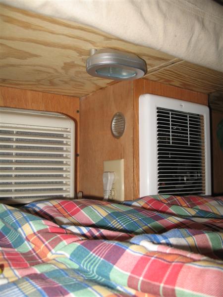

I was finally able to get a few better pics of mine also.
Round air intake beside heater for air exhaust...

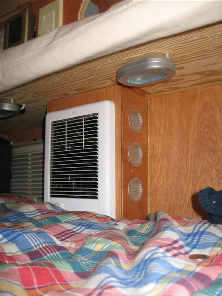

Round air intakes beside heater for air exhaust...

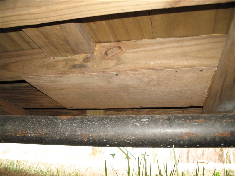

Bath room vent houseing under trailer....
My first attempt at venting incorporated the A/C unit being run on fan mode only like Larwyn. The square floor vent in front of the A/C is in the fresh air path on the way to the A/C condenser. I thought I could tap into this low air pressure area and vent the tear. It didn't work well due to my not being able to cut off the normal air flow for the A/C under the trailer.
