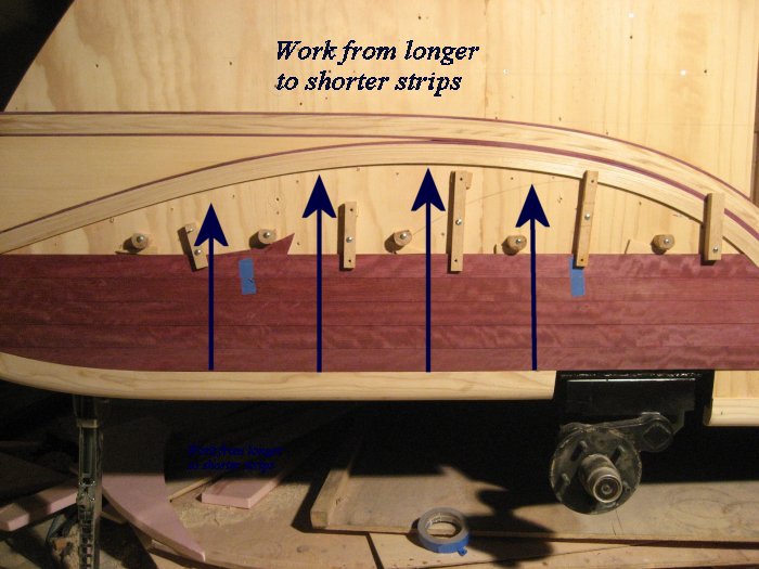

Juneaudave wrote: My little dowel pieces with wedges keep the strips snug. The wood lever holds the strip tight against the wood...there must be a better way but that is what I came up with!!!
