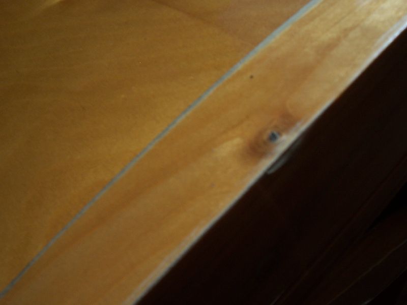

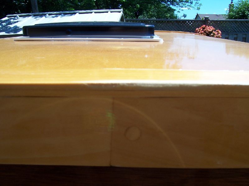

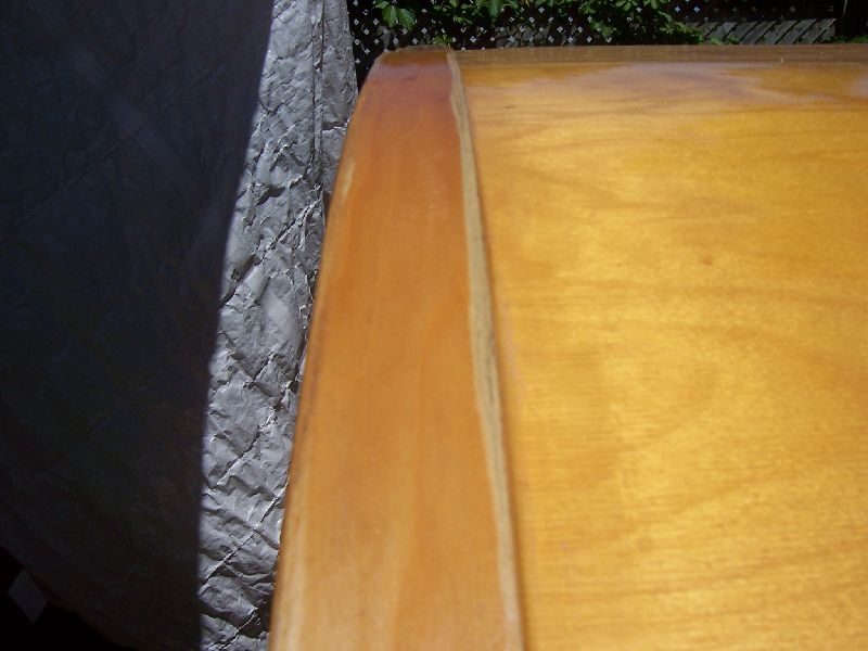

Postby Micro469 » Thu Jul 10, 2008 1:09 pm
Just to show what I am experiencing, here are a couple of pics....
Not very clear, but you get the idea.... :x

Postby Juneaudave » Thu Jul 10, 2008 7:15 pm
John...I've never really seen anything like that except on boat gunnels where tie down straps or something rubs over time.
Is it possible that there is a compatibilty issue going on? It sort of looks to me like either there is a stain/epoxy issue like the epoxy didn't penetrate in...or maybe...did you wipe down with a solvent of some sort prior to applying epoxy? It can sure be fixed but it would be real nice to figure out whats up. I know for a fact that the MAS epoxy I use doesn't adhere well with the oils in the purple heart unless wipe down with acetone first...that's why I ask....Juneaudave

Postby Micro469 » Thu Jul 10, 2008 9:32 pm
Juneaudave wrote:John...I've never really seen anything like that except on boat gunnels where tie down straps or something rubs over time.
:thinking: :thinking: :thinking:
The wood is Poplar,unstained. Just sanded. Now that I think back, I did wipe the sawdust off with a Tack cloth prior to epoxy.....That wouldn't have done it would it? I find the epoxy did not seem to penetrate the Poplar....... :thinking:
