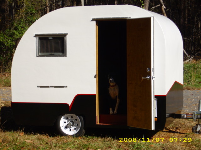

Postby kirkman » Sat Dec 20, 2008 8:37 am
That is what I built on. I moved the axle Under the springs to raise the body of the teat up. I wanted mine high....Cant wait to see your new design finished.
kirkman
Posts: 1270
Images: 55
Location: Elmira, NY
Postby shopfabricator » Sat Dec 20, 2008 9:52 am
Steve- I added a little to the door height on the clone I built by dropping the floor outside the frame rail. Makes a little step over to the main drop floor, but also added an interior step, no need to build and carry one for the height challenged camping buddies.Image
