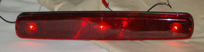

Postby wlooper89 » Mon Feb 16, 2009 2:10 pm
This is an ID light by Bargman in a single housing. Comes with either black or white base. The bulbs are slightly further apart than the minimum 6 inch centers. Any thoughts on how this one would look? I am not sure I like being able to see the inards of the light bar through the cover, but maybe that would be OK.
The first light bar I got is pictured earlier in the topic. It has ends with sharp corners that might catch on clothing at the galley, being mounted just below the galley door. And Patricia did not like the way it looks, an overriding concern. ;) Guess I will try to sell it on eBay.

Postby wlooper89 » Thu Mar 12, 2009 12:00 pm
I think adding this will make me street legal with a 90” wide trailer. The requirement applies to trailers 80" or more in overall width and the lights are on whenever the side ID lamps are on. To use as a center high mount stop lamp it requires a logic module, Bargman also makes that, to sort out stop signal from turn signals. I do not have a high vertical surface on the back of the tear and center brake lights are not required on a trailer so this is just for wide vehicle ID. The supplier I used is TexMood.com. On this model the 3 lights are on 7 1/2 inch centers, regulation says they are to be a minimum of 6" and max of 12" apart. The photo below shows the light bar just received, attached to a small battery. Installation to go. :thumbsup:
Thanks! Bill
