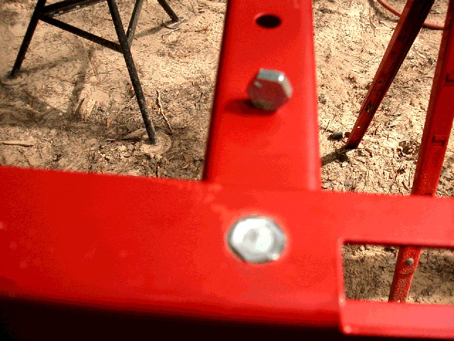

mikeschn wrote:
IraRat wrote:Understood, but there isn't like a higher grade of nylock to buy?
Is there? I don't know... I've never looked. But all the nuts are inside the c-channel, so you'd never see them.
If you find a better set of nuts and bolts at a place like McMaster Carr or something, please let us know...
P.S. Larwyn, what did you end up using?
Mike,
My 2000 lb HF trailer did not come with nylock nuts. It did come with inferior hardware. Several bolt heads actually twisted in two abvove the shaft leaving a very thin bolt head remaining. I used grade 8 bolts, nuts, flat, and spring washers from Tractor Supply. I am not convinced that nylock is any better than a good lock washer. The washer digs into the frame and the nut making it very difficult for the nut to turn counterclockwise. In fact removing one will deform the lock washer. Torque...?? I just tightend till it squeaks..... :D
Though probalby not necessary, I did weld my frame after bolting. Good insurance in case my theory on lockwashers is flawed.... :)
Larwyn
Larwyn
