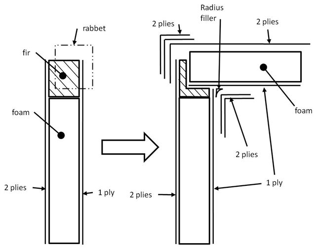

I’m thinking something very similar for the composite build I’m working on. Make the perimeter from fir then Rabbet the corner out and then use it as a form to wrap the cut (slits across the foam every inch or so that would go through ¾ inch deep in the 1 inch core) of the thickness foam/glass lower skin around. After the foam/glass is glued down, I’ll fill the gaps with microballs, smooth it and then glass over the top. I’ll follow with a radius filler on the inside corner and then a couple of fabric tape plies to reinforce the corners.
It the same basic layout though. They used to make cars the same way – build the frame (wood or metal) and then form the body over it (using the body as the tooling).

I'm not sure I'm clear on what you are proposing. Maybe a sketch would help. As I say, hollow core doors have cardboard separating the skins so the internal structure doesnt have to be heavy, just enough to keep the skins properly separated. More thin ones would be better than a few thick ones.
The trick to routing the rabbet is to build a larger base plate with a fence for your router so it won't tip. The interior skin will suport the extended base, the fence will keep the router bit the right distance from the outside edge, and away you go.

kennyrayandersen wrote:I’m thinking something very similar for the composite build I’m working on. Make the perimeter from fir then Rabbet the corner out and then use it as a form to wrap the cut (slits across the foam every inch or so that would go through ¾ inch deep in the 1 inch core) of the thickness foam/glass lower skin around. After the foam/glass is glued down, I’ll fill the gaps with microballs, smooth it and then glass over the top. I’ll follow with a radius filler on the inside corner and then a couple of fabric tape plies to reinforce the corners.
Kenny,
I like your plan. However, I do have a few comments. I have used glass over foam on a few projects. I don't think 2 layers of glass (outside) are going to give you much impact strength. Also, I found it difficult to get a smooth surface compared to glassing over plywood or faired wood strips. You may need many fill coats of epoxy (added weight) with lots of sanding to get a smooth surface.
You may have some professional method I am not familiar with to solve the above conserns. I just thought I would add my thoughts..........
Are you vacuum bagging the panels?
I assume you are building this way to save weight. I wonder if you will actually save much over using 1/8" or thinner plywood. 3mm marine plywood is really light and 1 layer of 3.25oz tight weave fiberglass only requires the epoxy wet out coat and maybe one fill coat. The epoxy used is the same weight as the glass., 6.5 oz total per yard (weight of glass plus epoxy).
The rest of your method is the same as mine, including the fillets and bias cut strips on the edges.
BTW/ if you dont already know, but your drawing looks like you do. Cut the 2 bias cut (hope your not using FG tape) fillet strips different widths, say one at 3" and one at 2", lay the 3 " into the fillet and add the 2" on top of it after the first one sets up. This way you won't be dealing with trying to blend 2 edges at the same location. The top edge will be 1/2" away from the bottom one.
The money saved by using less epoxy could go a long way paying for light weight plywood. Also, using light weight woods such as cedar for internal framing will further save weight.
