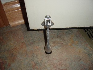

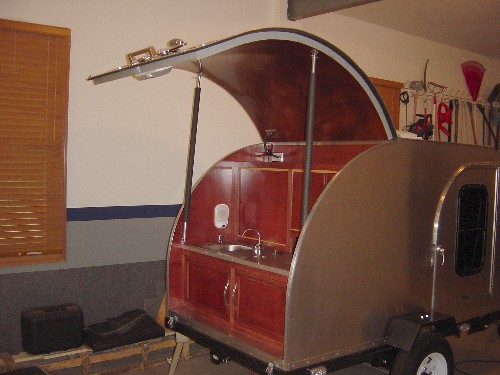

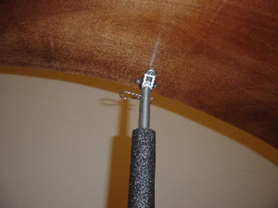

I designed my hatch props after the one Mike put on his 4x8 teardrop.
My hatch is big and HEAVY! I wanted the props to be strong and lock in position. So I decided to make my own and install one on each side of the hatch. Making my own also allowed me to determine/control exactly how much my hatch opens (cut to desired length).
The "pivoting hardware" at the top and the bottom of the props are door stops with the rubber end cut off. The rods are conduit. The black padding is pipe insulation. The padding keeps the props from beating up the counter and the inside of the hatch when traveling. The props are locked in place with cotter pins at the top. When not in use pull out the cotter pins and the props fold down and rest on the counter.
Image ImageDoor stops used as "pivoting hardware"

Postby TomS » Tue Sep 20, 2005 6:46 pm
Endo wrote:The "pivoting hardware" at the top and the bottom of the props are door stops with the rubber end cut off. The rods are conduit. The black padding is pipe insulation. The padding keeps the props from beating up the counter and the inside of the hatch when traveling. The props are locked in place with cotter pins at the top. When not in use pull out the cotter pins and the props fold down and rest on the counter.
I'm trying to visualize how this would work for me. I have a couple of questions:
Are you able to secure the support the hatch with one hand and insert the door stop into that conduit with the other hand?
Now, assuming you've got the first support in place. How do you insert the door stop into the second support without the first support poping loose? if you put put the cotter pin in the first side, how do you lift the hatch high enough to insert the door stop in the second support.
Tom Swenson
[email protected]
TomS
Posts: 1367
Joined: Thu Nov 18, 2004 2:06 pm
Location: Fitchburg, MA
Postby Endo » Tue Sep 20, 2005 7:51 pm
TomS wrote:I'm trying to visualize how this would work for me. I have a couple of questions:
Tom,
I insert one of the door stops into the support, then I lift the hatch slightly and pivot the other door stop and slide it in to the other support.
The "pivoting action" allows you to insert the second support without the first support coming out. You can also cut the second door stop shorter than the first to make inserting the second one alittle easier.
I then insert both cotter pins.
I should also note that when I fold them down I fasten the two props together with a velcro strap. This stops them from bouncing while traveling.
I hope that makes sense.
