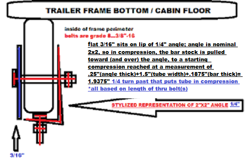

I see that you are all agreed that I shouldn't weld it, or bolt it either. I have been bolting things together for many years, though my welding has just begun, so I'm relying on the bolts to hold it together 'til I can take it to a welder/weld shop (all my welding/racing friends have disappeared, gone somewhere, so I'm on my own). I was concerned with the compressibility of the rectangular tubing (1.5"x3") when I will run in the thru-bolts, so that's why I am going to use the 3/16" flat bar as a continuous washer. Since the 2"x2" angle will protrude past the 1.5" wide tubing, there will be a ledge for the bar stock to rest on. When tightening the assembly in place, the bar stock will ride on, be supported by, and form a "u channel" with the angle. Using 2.5"(or longer) 3/8"-16 bolts, I will evenly tighten all the bolts until I reach a minimal/starting point where actual torquing of the tubing will commence. I'll measure the bolt ends to see that they are all drawn in to the point where the tube is being compressed (It can't deform upwardly-the floor rests on it, it can't deform to either side nor bottom-the flat bar and angle have it in a "u". I'll give the locking nuts a quarter-turn to put the tubing in compression. The crush sleeve won't be needed, since the bar/angle need only be pulled in to a known distance (as measured on the bolt-ends). Outlined here:
torquing of hanger assembly (theory).png (61.99 KiB) Viewed 929 times
I'll still need to drill inlets for the heads of the bolts holding on the hangers (a supplemental fail-safe to the welds), with a 5/8" drill, to create as small a hole as needed. Again, PL adhesive will be liberally applied to all three surfaces of the frame tubing. Then, when the adhesive is cured, off to a PRO welder, for the stitch welds. Back to the hanger welding procedure: until recently, I'd never seen hangers intended to lay on their sides to weld (I've seen hangers bolted on or welded in the vertical position, like these:

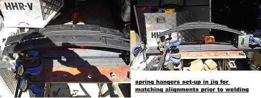

spring hanger assemblies in jig.jpg (63.34 KiB) Viewed 929 times
At that point, I bolted each in square, then started welding. Then grinding. Then welding. Then grinding. All afternoon long. I took out the bolts, and whanged on them with my BFH without any effect. I'm not happy with my welds; I'd make a good bead, then spatter and "grapes". Grinding, filling, ad infinitum. Still having trouble seeing the work as it progresses: sunlight interfering with my helmet auto darkening too much (eventually I'll make room inside the shaded garage). I also don't think my flux-welder has the power to make welding 1/4" to 1/4" very easy (I made multiple passes). I cleaned them up after I was done, and tossed them in my HHR Panel. I'll take them to the welder at work for :thumbsup: or :thumbdown:. He might even use his big machine to burn them in a little more (I wish I had the electrical sorted out to fire up my stick welder!).

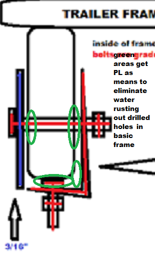

Postby working on it » Fri Mar 14, 2014 11:49 pm
I've really been too busy at work this week to reply (15.5 hours a day average x 5, plus 3.5 hours round-trip commuting). I did take the welded piece(s) to work Monday am, and had the opportunity to show it to the experienced welder. He approved it, commenting on the difficulty of 1/4" to 1/4" welding with a 125amp flux. He saw where I made long-duration spotwelds in several places to supplement the multipass beading. I asked if he wanted to use his big Lincoln on it; he said I had welded in plenty of solid material to do the job, and it didn't need re-doing. He also said that the grade eight bolt "safeties" were not needed, but I trust bolts more than any weld, so that's what I'm doing. He also said that I had as good a "welder's sunburn" as he'd ever seen (my neck-unshielded beneath my helmet- and inside elbows were beet red). I welded very closely (my helmet was only a foot away from the work), and I didn't even think about the UV. Next time, I'll use sleeves and a neck wrap. I'll also put a towel draping over the back of the helmet, to keep the shading consistent. As to the "spatter and grapes" occurring because of the welder not staying cool; possible, since I welded all afternoon (grinding also). I was using a 2 foot long 12gauge GFCI cord to power the welder. Perhaps it sapped some power, or maybe my home's (long-observed) line voltage fluctuations. I'm still waiting for my wife's cousin to fix my power supply problems. About the use of PL Adhesive: I'm only going to fill and surround the damaged metal and drilled out holes in the frame, to seal out water at those points.
PL Adhesive goes here.png (70.51 KiB) Viewed 867 times
Planned stitch welding would be not be directly in contact with the "cured" PL, so presumably it would not contaminate the welds. I'll add more PL to all possible water entry/collection points after the final stich welding is done, and prior to painting over the restructured frame. Proceeding to the attachment/cross-bracing phase tomorrow; I'll also trim the 3/16" flat stock to fit inside the wheel wells, drill pilot holes thru the angle to the frame, and temporarily attach it to start fabricating the bracing. Then cleaning all surfaces before mating parts, torqueing the bolts, and sealing same. Finally, maybe in another weekend or two, after mounting the new springs, I can re-measure for ordering the new axle and not use the measurements from the old axle. I just hope I can get it all done (since my new 75 hr workweeks and usual 18 hour commutes leave very little time for planning, working on the trailer, and sleeping!) in a few weeks, and in time for my April 25th trip to Beaver's Bend.

Your diagram shows limited use of the adhesive to allow for stich welding, which is good, but when finished you might consider using more adhesive to prevent water and debris from getting between your angle and plates and frame, where it could rot out the frame unseen.

Actually, I think I'll skip the PL between new steel and old. Having been really up close and personal with the original frame, I see that the open tubing has not rusted anywhere, even though it sat for twenty years over marshy soil. I can't imagine that the 3/16" or 3/8" thick steel would rot away in my lifetime, especially given the Texas heat, and inside garage storage. I will seal the outer seams to cut down on water entry, though. I used 5 bolts to secure the angle, with 3 of them thru the flat stock. 3/8" Grade 8. Has to be stronger than before.

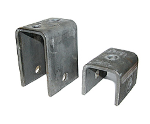

Postby Kody » Thu Mar 20, 2014 8:42 pm
I have come into this conversation somewhat on the late side of it. However, the question was asked, "why would the holes be drilled into the tops of both front and rear hangers, if that was not their designed method of attachment? -- using bolts."
These holes are "Tooling" holes that enable the flat strip to be located in the tooling (the dies) by the forming punch that pushes the steel strip into the forming die to bend the strip to shape. The punch has a spigot in the center of its face that fits into the hole in the strip to correctly align the strip for the sides to be pressed up in the die. Without the alignment hole and the spigot, the "U" shape could not be produced. The hole is not meant to be used for a bolt or as a "filled in" area for welding. The hangers should be welded on by welding on the sides only where they sit on the chassis. A small tack weld can be placed across the front and rear of the hanger but this weld should be a small stitch type only. The hangers should never be fully welded across the main frame of the chassis. Welding across the frame can greatly reduce the integrity of the steel tube. I know that a lot of people do it, but it's not recommended at all.
Drilling through the top and bottom of the chassis rails is never a good idea. The top and bottom surfaces are the sections that give strength to the tube itself. They are either in compression or tension depending on the way they are stressed (or loaded) at any given moment. If you drill a 3/8 diameter hole (or bigger for clearance for the bolt) through the top and bottom plates being 1 1/2" wide, ie, the top and bottom surfaces, you have effectively reduced the strength of the tube by 25% minimum. Fitting a compression tube and flat washer will never achieve the original integrity of the tubing. You might "get away" with doing this for a long time but one day it will surely fail when you don't need it to do so. I would never drill holes through the top and bottom of a frame. It's just not worth the risk.
