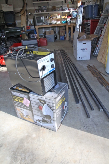

justageorgiaguy wrote:I've been following this thread as I plan to start teaching myself to weld as well. My dad has a Millermatic 135, will that be sufficient to weld .125 and maybe a little thicker square tubing?
KCStudly wrote:How do your welds look so far?
If the machine can lay good beads than you should be able to, too. If the machine is iffy, then how do you know if it is the machine or you?
Just saying. One thing to do to give it the best shot at laying good welds is to make sure you feed it an adequate supply of power. It may have already been mentioned but those little machines don't usually like being placed at the end of a long extension cord.
