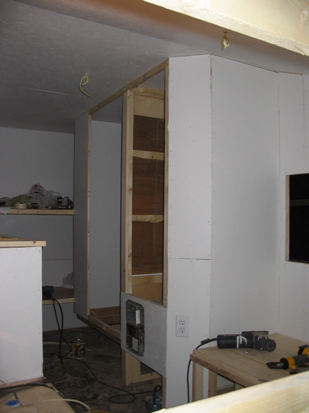

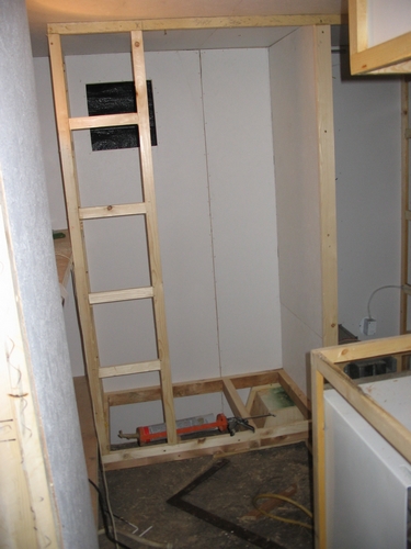

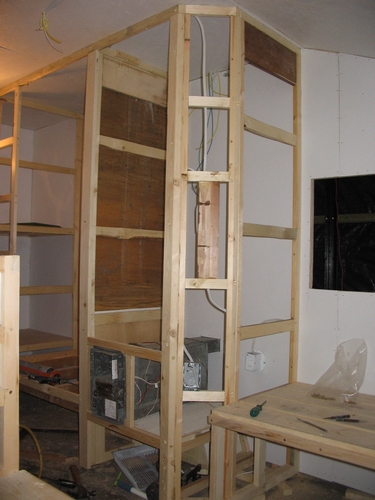

Here is the closet framed in. The 45 degree corner was a pain, but should make it easier to slip into the dinnette seat.

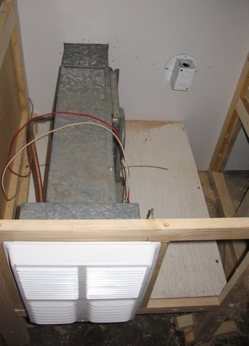

The furnace is intalled in the lower part of the closet. It will be boxed over before all is done.

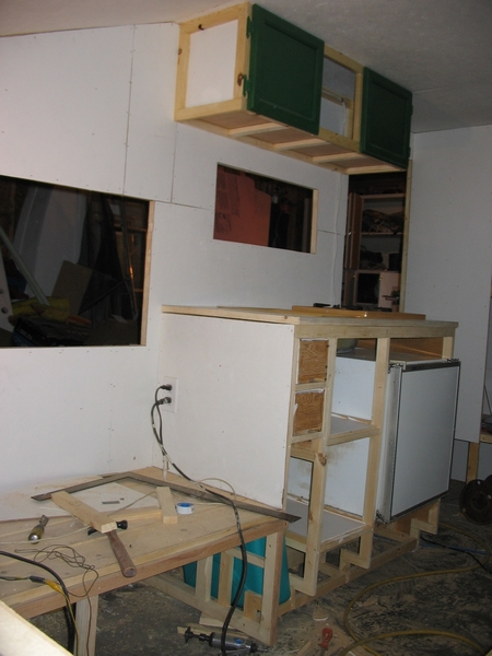

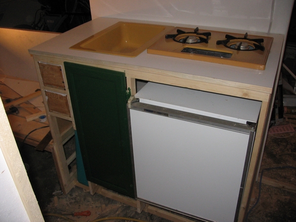

Here you can see the progress in the galley. The lower cabinets are all but built. Gotta put a top on, and install the sink and stove. Some sheeting left to do on the sides of the cabinets as well.

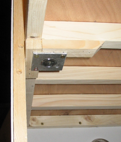

Here is a Cig lighter out of an old car, that will suffice as a nice 12V DC outlet for the kids to plug their portable nintendo's into. This one is under the top bunk, but there will be one nearer to the front of the trailer as well.

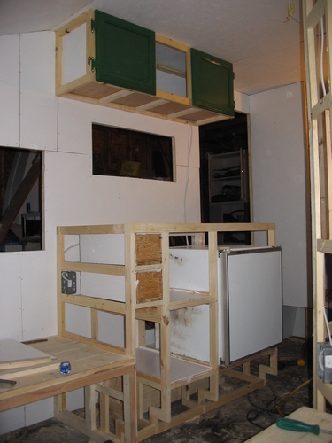

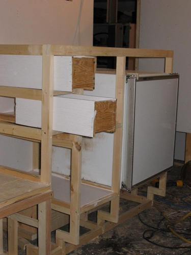

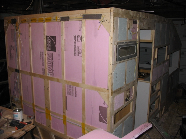

Here's the kitchen progress...
Insulating the walls....
Closet progress...

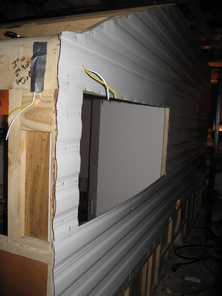

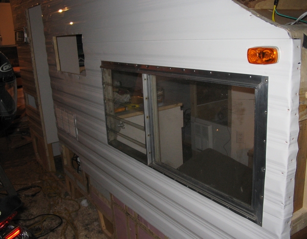

Postby Gerald_G » Mon Jun 25, 2007 1:18 am
More progress today...
Started in on the aluminum siding....

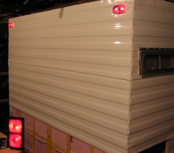

Postby Gerald_G » Wed Jun 27, 2007 1:00 am
Thanks for the note Martha.
Here's some more progress, and some more pics.
I hope to have it water tight next week, and move it out of the garage and attach to the floor and wheels.
I'm going hiking this weekend though !! wahoo

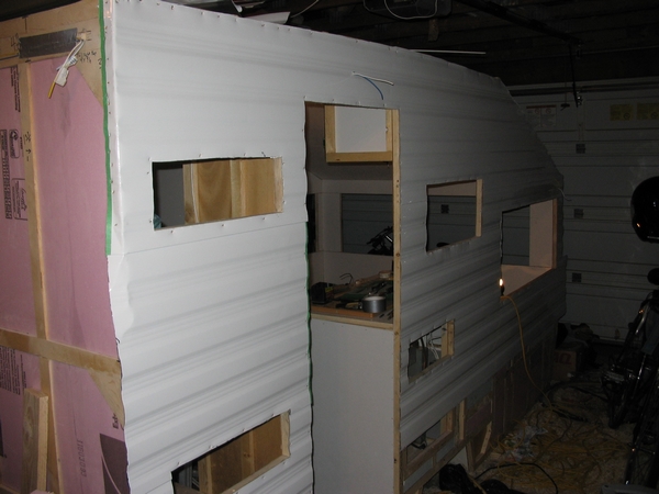

Siding the Drivers side as well. Not many windows thankfully...
Here's progress on the passenger side. Starting to get the windows going as well..
And the rear is coming along. The marker lights work ! Yay ! - also hooked up a tail light with alligator clips to see if the tail light wires were ok. Yay they are...

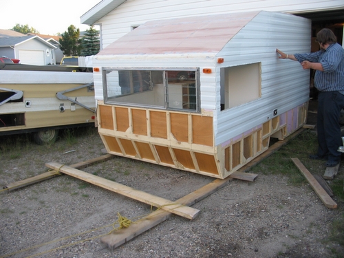

Postby Gerald_G » Thu Jul 05, 2007 1:14 pm
Took a week off work to Get 'R Done.
I am planning in camping in it starting Fri for 10 days, so I'm busy busy on the trailer. I'm posting as I take a wee break from the blistering sun, to avoid getting over cooked out there.

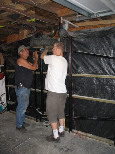

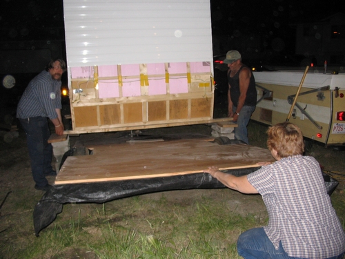

Two nights ago, my Dad, Bro' in law, and I got the body and frame out of the garage and attached to each other. With ample supervision from my Mom and Wife, we got busy.
I do not recommend this build method, bacause there is a lot more work involved than at first I thought doing it this way.

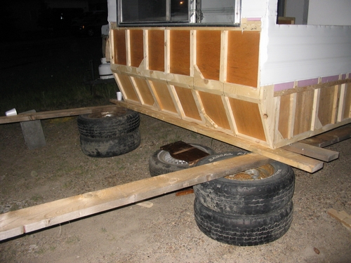

Here we are sliding the body out of the garage on skids.
Then we start jacking it up and blocking it in the air, so we can slide the fram underneath.
Next to retrieve the frame and floor from where it was stored on it's side in the garage. We had to put on a tire first.
Then we start sliding the frame under from the rear. This photo is somewhat staged, since we really did not lift by hand, we used my tire jack.
Once underneath, we lowered the trailer body back down onto the frame and floor, and tada, a Tiny Travel Trailer is born.
This took us till midnight, and I must say, it is a lot easier to simply describe it and post pics than to execute this manouver in reality.
More to come.....
Gerald

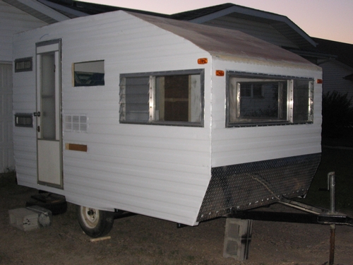

Postby Gerald_G » Thu Jul 05, 2007 1:19 pm

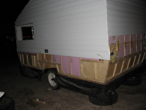

As of last evening it looked like this.
I'll try and post again after todays work....
