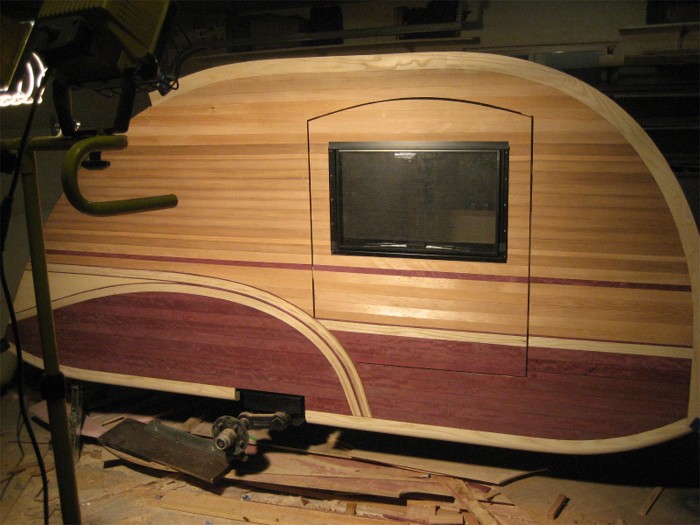

First off...about ripping cedar boards. Cedar comes in an amazing variety of colors and an individual board may change colors thoughout its length. The range of colors can go from a very light cream colored to a dark tan, to a deep red. One of the things that the homebuilder can do is index your strips as they come off the board (BTW...many of the best kayak shops that supply kits now number their boards as they are ripped to keep them in order.) I tend to lay them out in order that I rip them and then bundle them so I have a sense on what I have when I set up for stripping!!!
Some stripping designs are random, but I have always thought that the best were in some sort of pattern. On side two, I tiried to do something similar to side one. I ran a bunch of the darker strips along the line of the window...and used a 1/2 cut lighter strip to transition. It's a little hard to see on the raw wood...but once a finish is applied the contrast will be substantial!! Phew...here's a pic of side two stripped!!!
Next...I'm going to lay that side back down...use Roly's beltsander tutorial, fill the cracks, block and finish...we'll see how it goes!!!

Postby Sonetpro » Sat Oct 20, 2007 9:56 pm
WOW :o
:thumbsup: :thumbsup:

Postby Chaotica » Sat Oct 20, 2007 11:26 pm
Damn.

Postby Classic Finn » Mon Oct 22, 2007 5:05 pm
:o Yupper :o :shock: Way Cool...Beautiful :applause: :applause: :applause: :applause: :applause:
Your amazing for sure.. I cant wait to see it done..
Im speechless... :applause: :applause:

Postby Juneaudave » Mon Oct 22, 2007 8:55 pm
Thanks guys...Boy, was I happy to get that last side stripped. It really took me forever and I'm a little burned out on TD sides for the time being. Happily, I'm in for a welcome break from work and teardrop trailers!!! On Sunday, I'm flying out on a float plane to a FS cabin for a week of hunting and cutthroat trout fishing with a couple of friends. Yippee!!!!

Postby Mike C. » Mon Oct 22, 2007 10:16 pm
That is really fantastic. :thumbsup:
I agree with Heikki, I can't wait to see it finished.
It is beautiful. :applause: :applause:

Postby Tcurr » Tue Oct 23, 2007 7:17 am
That looks amazing. I am sure that was a ton of work but definately worth the time. Wonder if I can talk Mamma into letting make another 8)
