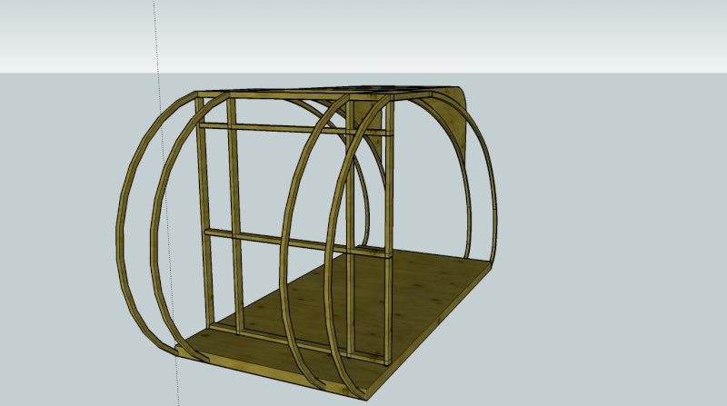

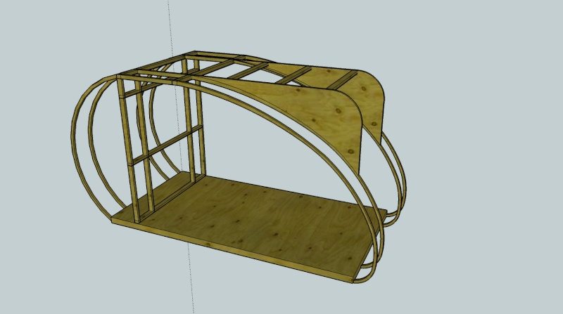

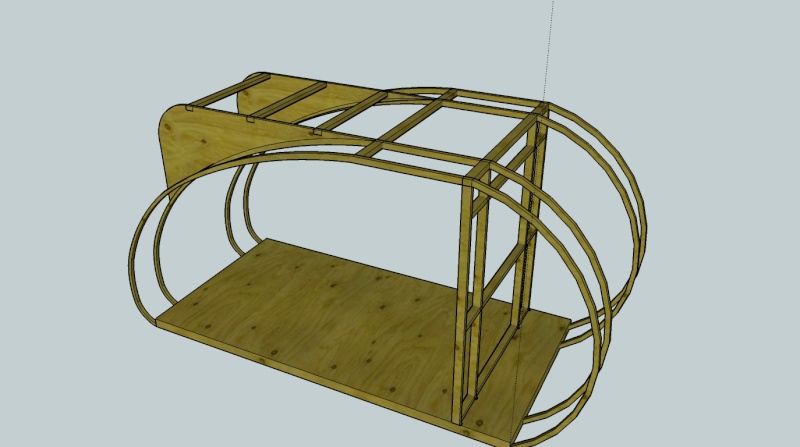

I've been designing the structural frame... there will be a hatch at the back and at the front (the front end being the galley), so there are no struts for there, and the two far outer sides will be virtually solid... but is there anything glaringly wrong with this frame idea?
I've rotated the SketchUp drawing to see it from different angles... I know my 3D skills aren't up to much... its took weeks to get to this stage :oops:
I've got some additions to the framing for the beds and some more framing for the galley to do (really like the design Duane did with the fold out table in the centre) but does this look right so far?
Cheers, Dewi

Dewi, why do you have 4 profile ribs?

Postby Dewi » Thu Apr 16, 2009 2:49 pm
Mainly because the galley area at the front opens as a split front top and bottom and so does the back... I couldn't figure out a way to give the structure some rigidity because the connection points were the flattish bit of the roof (which won't be flat, but near as) and the bottom of the side walls.
My theory was to build the two sides as sort of fixed units about a foot wide, then there would be more connection points to the chassis/base. I've not drawn in all the noggins in between yet.
Originally I wanted the Jim Dandy shape at the front, but after studying a design Duane did, I figured I could use some of his space creating ideas for the galley, then come up with some unusual uses for beneath the galley area.
Do you think it will work like this Jeff or am I making more work for myself unneccessarily?
Cheers, Dewi

Postby WarPony » Thu Apr 16, 2009 4:11 pm
Ah, I see. Kind of a clamshell opening for the hatches, interesting design. Extra work?!?! Hell, building campers ALWAYS takes extra work to make them like you want!! Get in there and have a good time, I'll be watching the build, Dewi. :thumbsup:

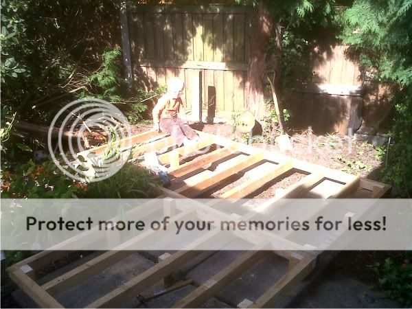

Postby Dewi » Thu Jan 26, 2012 7:31 pm
Only pictures I can share at the minute is a project I took on with some scrap wood... I wanted my kids to have something they could enjoy despite us being skint.
Image[list=]
Image[/list]
Its very nearly finished, I have the staircase ready to go in, a carpet and a heater... but the kids love it. All made with the scrap wood donated by a hire company who were moving premises and offered to give me their old shelving.
Not a TD I know, but woodwork is my passion and I hope that the Dandy will make use of me.
