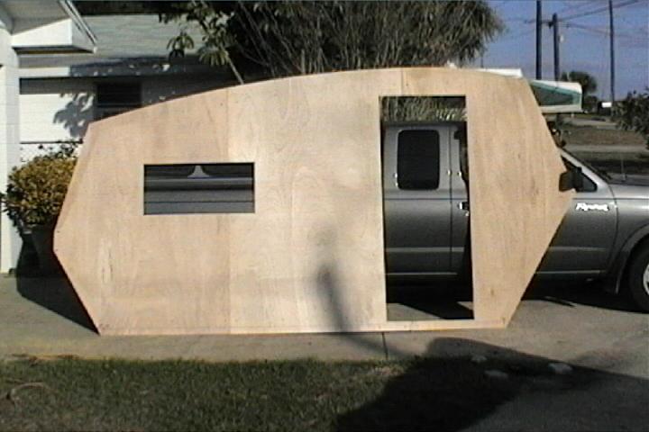

Postby cracker39 » Fri Feb 17, 2006 4:57 pm
Another day, a little more progress.
:hammer:
Although you can't see most of the pendil lines in the sun, I drew in the framing for door, window, bed supports, cabinets, etc. and cut out my template. For now, here's a picture of it against my truck for size comparison. That dark spot at the front is the shadow of my outside mirror.
Now that it is wood, it's taller than it looked on paper or the model. I have 4-5" over my height, that I don't really need, but if I sell it, I don't want to turn away tall people because they can't stand up in it. And, I think I didn't get the front curved down as much as I'd like, so I may change that. Otherwise, it pretty much looks like my model. Tomorrow, if my router cutting bits are sharp enough, I'll start on the sides. I have some bits coming from Rockler, but they'll be a few more days getting here. I'll put progress pics in an album later...right now, I'm just too darned tired to do it.

Postby mikeschn » Fri Feb 17, 2006 5:45 pm
Hey Dale,
I guess your models were playing tricks on us. It actually looks a whole lot bigger than I thought. It's definitely a tiny travel trailer... right up there with my tab, and some of the canned hams folks have been buying as their second trailer.
But it looks good... and it's not too late to work on that back top curve! :frustrated:
P.S. Can you show us a picture of the backside of that panel. It'll help in the joining/jointing thread!
Postby cracker39 » Fri Feb 17, 2006 8:31 pm
Mike, as a template, It is 3 pieces. I just connected them with screws through them into some scrap wood for the shot of the profile. I'll actually cut my 3 side pieces individually and connect them with the framing pieces during construction. Then, I'll have a shot of how they are joined. I plan on having a couple of hoizontal framing pieces crossing the joints, and inbetween them, vertical 3" pieces so that the joints are completely backed by framing. Pics will show them after they are built in a few days.
The curve down the back isn't the one I was referring to. I actually raised the rear end of the back curve about 6" since my model. It's the front that had a tighter curve down in the front that I was referring to. It doesn't curve down like I had it in the model and I may trim it down a couple of inches to lower wind resistance. In the pic below, the yellow line is the curve I have. The green line is the curve I think would be better.

Postby mikeschn » Sat Feb 18, 2006 3:42 am
cracker39 wrote:Image
A full radius on that top front corner would also work. And you'd be able to bend plywood around it. Make it a 19" R or so...
Postby cracker39 » Sat Feb 18, 2006 8:06 am
Mike,
I'm not sure just how tight a curve I can bend 1/4" luan. I'll clamp a piece to some timber and try to bend it and see. I guess I could make kerfs about 1" to 1 1/2" apart in the front 15 inches of it to facilitate a tighter curve. I would really like the front edge to be a little lower to help reduce wind resistance. I think I'll work on it today to see what can be done to lower it without sacrificing my stand up height above the door.
As to why my profile looks larger than the model, I know the answer. I put a printout of pictures of ourselves on the side of the model looking out the windows, and they are out of proportion. The pictures of us should have been reduced more in size to get a true perspective. What does surprise me is that the actual profile looks so much longer than it did in the model (perspective again). I checked the model, and it is a half inch taller than it should have been for true perspective, but that shouldn't have made that much difference.
Anyway, I am pleased with the result so far, but, if I ever build another on this plan, I think I'll try it with the profile as a continous curve, more like the Widget. I think that would have a real retro look of the 40s and 50s. And, it would increase the interior volume slightly without adding more than a few pounds of weight. Avoiding having to make all those curves was the main reason I squared off the front and back. I sacrificed part of the retro look for easier building.

Postby cracker39 » Sat Feb 18, 2006 12:46 pm
Mike,
I tested the amount of curve I can get on a 4' wide piece of plywood, by clamping one edge to a timber and another thin strip to the edge, 15" from the timber. That's the distance I'll have to bend. I put clamps on the thin strip and my frame to pull it down. I got enough bend to lower my front curve 3 more inches. I also darkended the lines for framing and spars so they can be seen in the photo. In the new photo, you can better see the different sheets by the variation in color. Here is the result:
