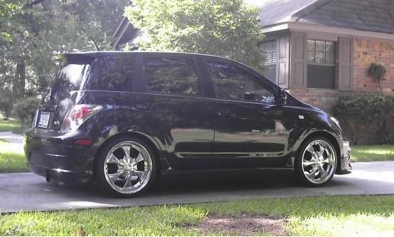

steve wolverton wrote:Is that blue Scion XA yours? I had a gray one.
I've got a subwoofer box for two 12" speakers that you can have if you want it.
:D :applause:
Its my black sand perl... One of my other hobbies... Wow, hate to see you got rid of it, but guess you couldnt pull the puffin with it, or maybe you could of 8)
