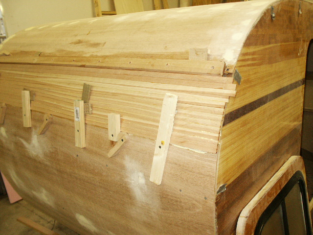

Todays progress
Postby prohandyman » Sun Dec 02, 2007 11:05 am
ImageDoors hinged and mounted temp
Image Front strips going on
Dan

Postby Juneaudave » Sun Dec 02, 2007 12:10 pm
Dan....In preparation for stripping the top of the SlumberMax...do you think you could get enough clamping pressure by running 4 or 5 tie down straps over the top? That was kind of my conceptual, not having been there.

Postby prohandyman » Sun Dec 02, 2007 1:30 pm
Dave
What would you connect the straps to? Would you make a lap all the way around the perimeter? Would have to be awful long straps! My guess is that the straps would have alot of stretch in them, but you might be able to add blocking between the straps and the strips , right where where you need the most pressure, to "shim" for a tighter hold! I've seen several builders on the forum use straps to hold ply down, but then again they don't have to put pressure evenly on multible strips. Steve Frederick uses a warped 2x4 under a strap to put pressure on his 1/8 ply! Might work here! :thinking: Love your tree ornament!

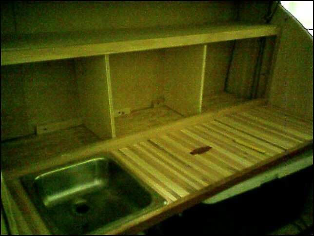

Todays progress
Postby prohandyman » Sun Dec 09, 2007 11:06 am
Sink in and cabinets framed

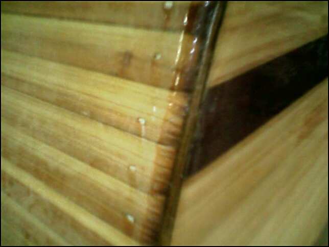

Postby prohandyman » Tue Dec 11, 2007 4:26 pm
Finally got front epoxed

Postby WarPony » Tue Dec 11, 2007 6:41 pm
Dan, can you show how you finish the edges?

Postby prohandyman » Wed Dec 12, 2007 5:27 am
sneak peaks available daily! Its at hangar 18, area 51, so I will have to blind fold you to take you in! High security 8)
Jeff
I will take a few photos today, but I'm going to make edge trim for it to cover edges though.

Postby prohandyman » Wed Dec 12, 2007 12:21 pm
Jeff
I don't know if this pic helps or not. Corners rounded, nail holes will be covered with trim, then more epoxy!

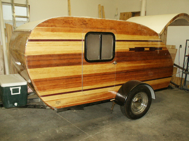

Ready for trim!
Postby prohandyman » Sat Dec 15, 2007 3:13 pm
Finally, stripping and epoxy are done! :applause: Ready for trim and varnish! Steel fenders are temporary until funds are appropriated for fiberglass.
