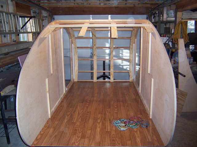

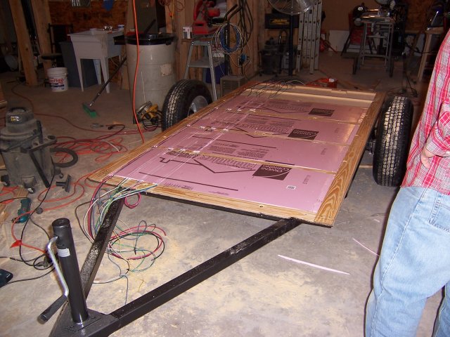

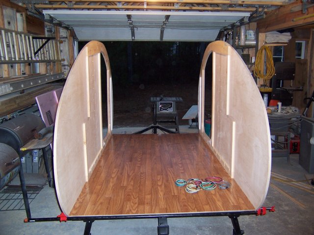

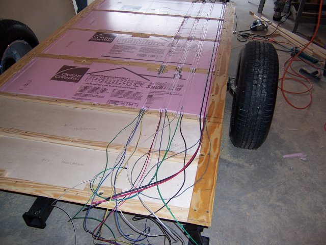

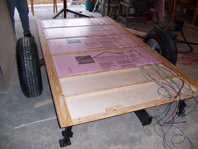

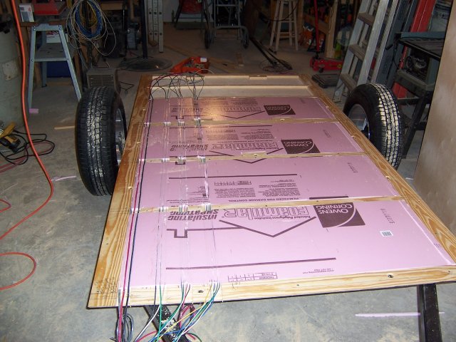

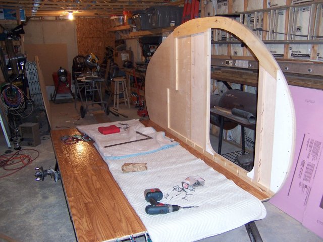

Well i'm glad to say progress is being made, My frame is completed. I built my floor, sealed it with roof and foundation coating, rolled 1 coat length ways and 1 coat width ways. Attached it to the frame the next day, when it was still tackey, I figured it would help seal it to the frame.

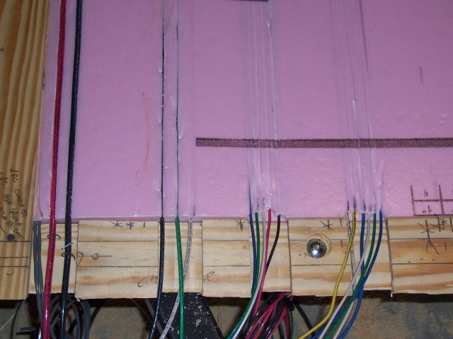

I ran alot of my electrical through the floor as I built it.

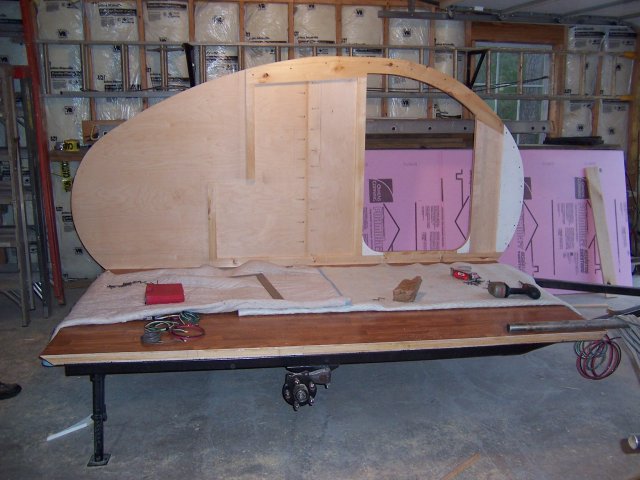

Once that was finished I decided to put my flooring down, I hate putting sheet goods down and this would be the least trouble. Then I got my sides set up how I wanted them and they are installed.
And that's where I am at this point, it's getting there and I'm having a blast. :thumbsup:

Postby Rob » Thu Jan 05, 2006 7:18 pm
:thumbsup: :thumbsup:
Looks like a teardrop to me. :applause:

Postby Hardin Valley Magic » Thu Jan 05, 2006 8:25 pm
schreimaster, I gotta say that floor looks great. :thumbsup:

Postby schreimaster » Thu Jan 05, 2006 8:42 pm
Thanks, Home depot $18.99 and its a heavy material, can't beat that.

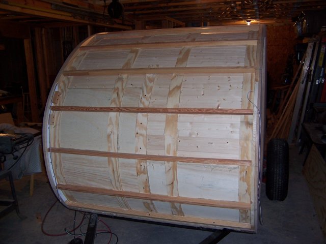

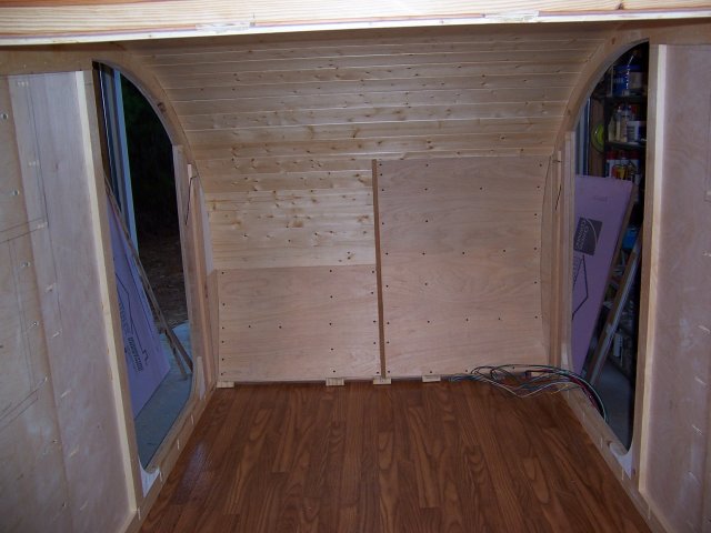

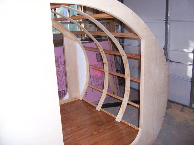

Well some serious headway has been made over the last few days. I finished getting my ceiling together. I was giong to put panneling in the interior, but after some thinking I decided to go with 3 1/2 X 3/8 pine tung and grove. So with this being said I framed my ceiling a little diffrent.
And then I installed the tung and grove with liquid nails and my brad gun, I have to say I am very pleased with the outcome.
I am going to do the interior walls the same way. All the tung and grove was pre finished in my shop before installins. My fenders are on order and I hope to get the outher skin of the roof installed soon.
