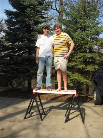

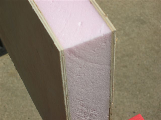

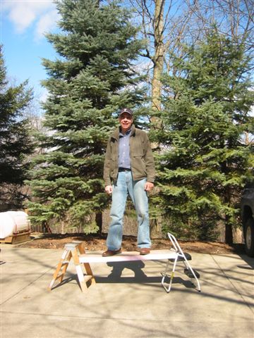

I was very happy with the results:
I feel this was my best panel to date. I used three 60 lb. sand bags to clamp the panel during cure. I removed the bags after 6 hours. There was no sign of delamination around any edges and this was with only 0.3 psi clamping pressure! I still think I need more, but I am convinced that 1-2 psi will probably produce a panel strong enough for my teardrop needs.
I recruited my 15 year old ( 6'3 220+ lb) son to help "test" the panel.
Imagine trying that with a sheet of 3/4 in plywood. And this panel weighs less than a 1/2" sheet of plywood ( and has about R-11 insulation to boot).
