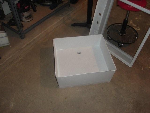

Postby Donutboy » Sat Aug 25, 2007 9:04 pm
I have a "Puffin for Four" build in progress. I just picked up a Goldstar 5050 BTU air conditioner for $70 that has provisions for a drain hose.
For the showe pan, I'm using a utility sink I bought at Home Depot for $30. It measures roughly 19" x 21".
Jerry

Postby steve wolverton » Sat Aug 25, 2007 9:05 pm
Donutboy wrote:I have a "Puffin for Four" build in progress.
Let's see some pictures! :thumbsup:
Good idea using the sink for a shower pan.

Postby Donutboy » Sun Aug 26, 2007 12:59 am
Here's a pic of the shower-pan-to-be. I'll cut the "walls" down a little more before installation.
I've added pictures of my build thus far to my Album if anyone is interested. Floor is basically done (except for undercoating). Working on the walls now.
