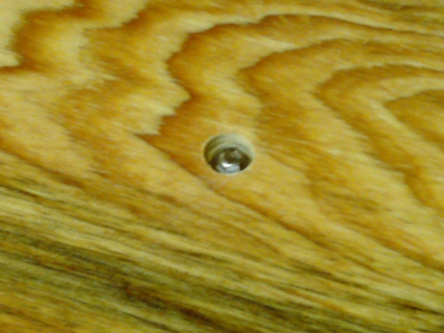

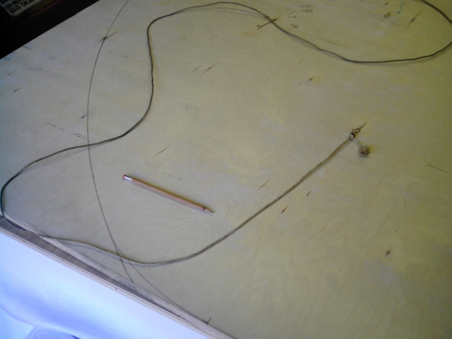

The floor assembly got attached to the trailer frame, using 3/8ths inch stainless steel bolts with flat washers and nylock nuts.
I counter sunk the holes with a 7/8ths inch Forstner bit, drilled down just enough to let the bolt head be flush with the floor.

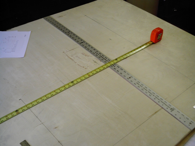

I marked out all the dimensions for the first wall panel.
I used the string compass to mark out the radii of the door and front and rear of the side wall.

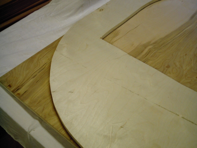

After cutting out the first side wall I flipped it over onto the second piece of wall plywood and made my marks using the first piece as the pattern.

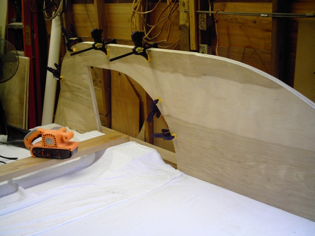

After I got the second wall cut out I matched all the ends and edges lined up and clamped them together. I then used the belt sander with a 50 grit belt to get both edges of the walls smooth and matching.

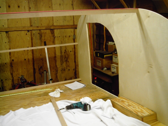

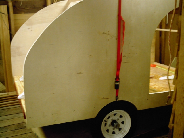

Postby SkipperSue » Sun Nov 12, 2006 6:04 pm
I dry fitted the walls today. I had to mount one side to get the arc needed for the wheel wells. I got the arc using the string compass, from the center of the bearing cap I got my mark to the bottom of the floor. Worked great. :thumbsup:

Postby SkipperSue » Mon Nov 13, 2006 5:06 pm
I used the 4x8 foot HF trailer. I have it 62 inches (5 foot 2 inches) wide. The wheels are almost all covered by the body.
