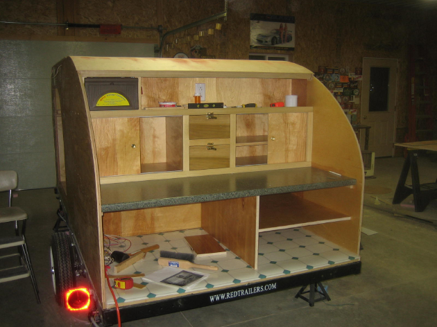

I used 1x2 poplar for mine and like the way the face frame turned out. look at your kitchen cabinets for ideas. There is probabaly no right or wrong way to do it as long as it looks good and you like it.
