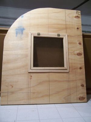

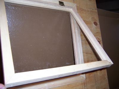

Postby dwgriff1 » Sat Jan 27, 2007 6:01 pm
I made my own windows based on a design that Andrew suggested. It is all wood, a hopper design (tilts in from the top) has a seperate screen and works well. Mine is glazed with plexiglass and the whole thing lifts out.
Each side is exactly the same.
I'll see if I can find the URL for Andrew's sketch.
dave

Postby dwgriff1 » Sun Jan 28, 2007 4:18 pm
Andrew,
I am very pleased with that design. I built it so the glazing lifts out, so when necessary, I have a lot of ventilation.
Haven't had it in a downpour yet.
dave

Postby dwgriff1 » Mon Jan 29, 2007 2:38 pm
I have no problem with buying windows. If you are building an aluminum clad tear then alumin windows look pretty nice.
But, if you are building an all wood tear, and that is important, or if the budget just won't stretch, then there are alternatives. They take more time, but they can work very well.
I just posted some picture of my solution on my album.

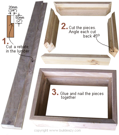

Postby amandastevenisbet » Tue Jan 30, 2007 7:42 pm
Just found this easy homemade window. Looks great to me. Also very inexpensive and easy to make. Tell me what you think.
Steven

Postby mikeschn » Tue Jan 30, 2007 7:59 pm
That's similar in many ways to what Dean has...
http://www.deansofidaho.com/teardrop/wi ... ndows.html
Postby halfdome, Danny » Tue Jan 30, 2007 8:14 pm
Replace that ugly strap hinge with a piano or hurricane hinge and it would be quite nice. :thumbsup: Danny
