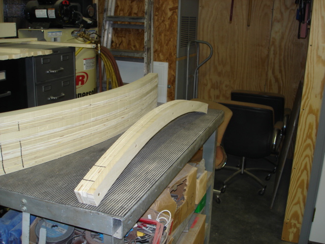

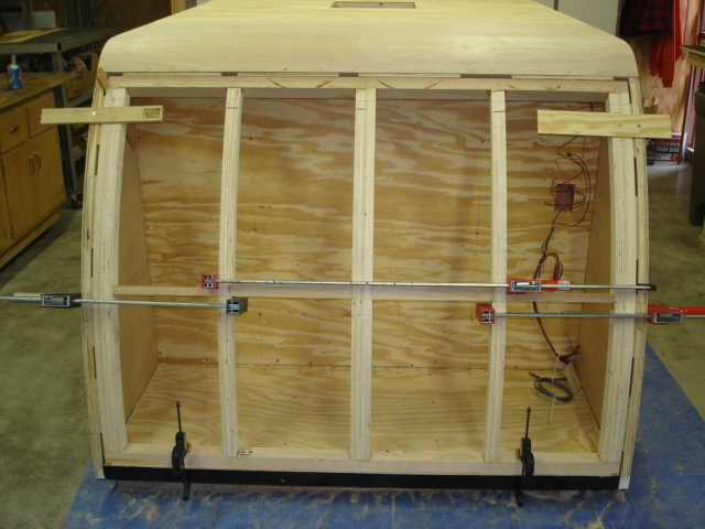

I read the Benroy plans above and it recommended covering the galley hatch with 1 sheet of 1/8" to prevent spring back - however, I've already done my whole roof in 1/4"..so to keep everything flat I need to go w/ 1/4" on the galley lid. The curve is pretty gentle and I can bend the 1/4" no problem, but would it be better to have 2 pieces of 1/8". Which would be best to prevent springback? Total of 5 spars. 3 are 2.25" wide (2 pieces of 3/4" plywood and 1 piece of 3/4" poplar glued together) and 2 are 1.5" wide (2 pieces of 3/4" plywood glued together), all are 2" deep.
Spar curve template:
Spars and blocking in place till glue dries.

Keith, since you have a hinge between the roof and the galley hatch only your total thickness for clearance matters since they will flush up together. I put two layers of 1/8" Baltic Birch on the roof and only one layer on the hatch. Do a mock up with your gasket to see if everything adds up to the correct thickness before putting on a second layer that adds more weight for you to lift. :D Danny

Keith, your hatch sides/edges look very thick and strong. I doubt whether you'll have ANY problem with springback.
How thick is it? 1 1/2"--from two pieces of 3/4" ply laminated together? And looking at the photos, you might have gone even thicker, huh?
Springback can be a problem when you go too thin with those hatch edges, like just 3/4", but yours look solid as a rock.

Ira: The two end and middle spars and 2.25" thick - two pieces of 3/4" ply and one piece of solid 3/4" poplar all laminated together. The other two are just two pieces of 3/4" ply laminated together - total of 5 spars w/ blocking in-between. 1/4" space/gap on sides and bottom, 3/8" space/gap on top at the hinge. The hinge spars, body and lid, are 1.5"x2" oak each.

p.p.s. with the "tank" like construction of your hatch frame, you shouldn't have any problems with springback..........
