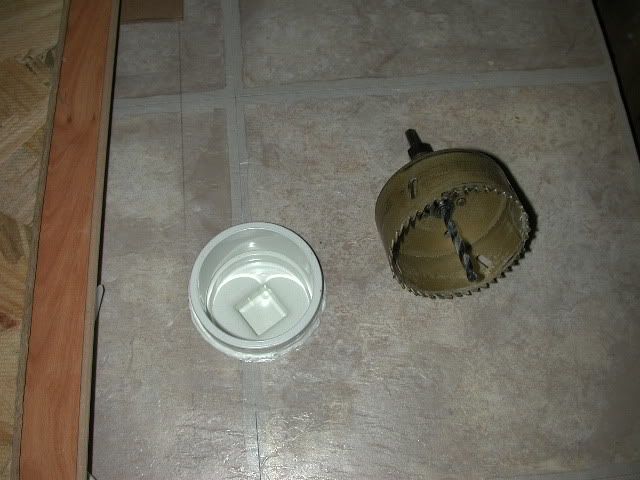

Postby Mary K » Tue Mar 06, 2007 5:47 pm
War, I installed a 3" PVC access pipe in the floor in the galley cabinets for a A/C hook up.
Then covered it with a plenum up the bulkhead (silver thing)
and installed a vent cover inside.
IF ya had enough suckidge :o from the Vent Fan and opened this access/pipe, whatever, it could pull air from under the trailer.
Just a idea to roll between your fingers...

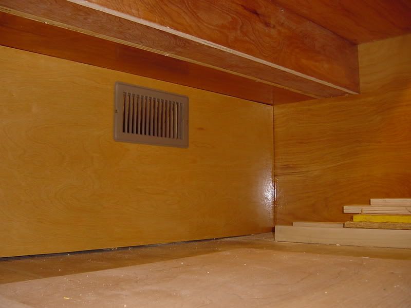

Postby 48Rob » Tue Mar 06, 2007 7:05 pm
Hi,
I put a floor vent in my Cabin car...slightly different than the average tear, since there is a small amount of open floor space.
I used an adapter from a heating/cooling place to protect the hole from road spray, it covers the hole, and places the opening toward the rear of the trailer, and is angled down hill so any water that might get close runs right back out.
There is also an insect screen inside the adaptor, to keep unwanteds out.
The inside has a nice brass and bronze grill that is plenty strong enough to step on, though it is near the wall.
The theory was since warm air rises, I could use it to bring cool air in from underneath, and push warm air out the top vent.
It works pretty well, as I have a fan in the adaptor in the floor, and a fan in the roof vent.
They are wired together, so one pulls air in, and the other pushes it out.
Does a good job up to about 85 degrees, then its time for the AC.

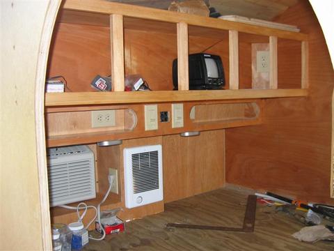

I vented through the bottom of my tear. I used a wall heater that required some air space around the back of it. I found that arispce useful running electrical wire behind the heater. On the sides of the heater I installed those round aluminum vents some of us use on the outside of the tear.
Under the tear I mounted a bathroom vent fan and ran power to it through a dimmer switch to keep the noise down. As it turned out the noise was not a problem.
This was a later addition and does not show up well in my build pics. There is one pic, though, does show the heater and just barely visible is one of the vents on the side where air is sucked out of the tear. Fresh air enters through some vents on the exterior sides of the tear above my cabinets. Or the windows if open, or around the doors. :roll:
Pic with vents barely visible...
Pic before venting...
Pic 2 before venting...
