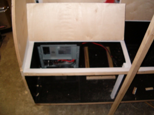

Postby elmo » Mon Mar 19, 2007 3:58 pm
sandman wrote:Dude, I am not even at that stage yet since I had to start over..lol. I ended up having to recut a wall when I tripped in my shop and fell onto the wall right after I had attached it to the floor several weeks ago. I just finished painting my custom made 6x12 trailer this morning. I have been waiting for good painting weather for days. I started painting on Friday and just did little by little and finally finished it this morning. As soon as the paint hardens up, it's time for the walls once again.
Did you get a Parallax Power Center like I bought off Ebay?
Same one...I was thinking about getting it about the same time you got yours. Pretty straight forward and looks good!
Sorry not the best picture, but you get the idea. The unpainted wood frame next to it is for the battery and all the wiring is behind it.
