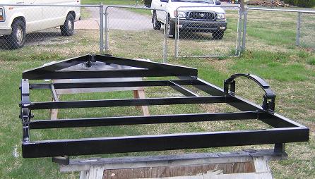

Lynn,
The way madjack sugested to you is the way I did my trailer. I removed the small leaf from the 2000 lb axle. I have the shock kit and run the tire pressure at 28 lbs on 15 inch tires. The trailer weighs 1,000 lbs and tows real good. I have been thinking of trying the tire pressure at 25 lbs due to the light trailer.
Shock mount
Improved shock mount

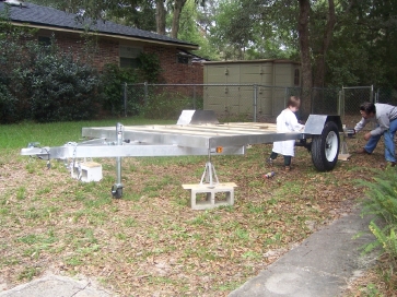

Here's a shot of the trailer right after we picked it up. Note the height between the wheel and the top of the fender.
Currently I can't fit my fingers between the tire and fender. Does this mean we need more leafs?

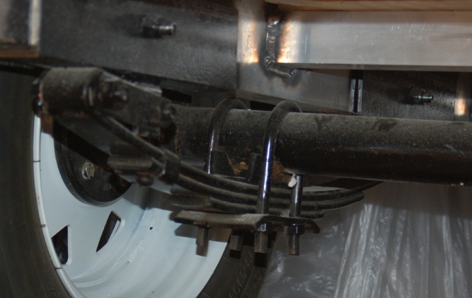

Postby Lynn Coleman » Mon Mar 26, 2007 11:04 pm
jplock wrote:Lynn,
Hi JP,

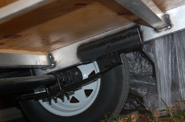

Thanks for posting. We'll have to contact the man who made our trailer to find out the how many pounds our springs and axle are rate for but maybe this picture will help. It's of our driver's side spring that shows how it is mounted to the frame.

Postby Phil & Ningning » Mon Mar 26, 2007 11:21 pm
I can't see it for certain, but it looks as if your spring shackle is horizontal. If so, that would be your problem, and re-engineering the suspension geometry is in order.

Postby Gage » Mon Mar 26, 2007 11:29 pm
Looks to me that your axle may be hitting the frame and in turn lifting the whole trailer because of lack of up & down travel not allowing the springs to function as designed.

Postby dahoon » Mon Mar 26, 2007 11:44 pm
A big part of the problem is the mount for the rear spring shackle is too far forward. Causing the shackles to lay flat, they should be nearly vertical.
I usually figure 750 lbs. per leaf that is 1-3/4" wide. Which looks like that is what yours are.
I am guessing that because you have very little spring travel and your tires are pumped up tight, that you are bouncing on the tires when you hit a bump.
Put this all together means: first move the brackets back(will raise the frame giving you more axle clearance), drop the air pressure to 30-35psi., adding shocks will help take the bounce out and keep the wheels on the road where they belong, and if need be add another leaf-although you have plenty of arch and travel.

Postby Kevin A » Mon Mar 26, 2007 11:54 pm

Lynn,
It appears to me that you could move the angle iron spring hanger that is bolted to your frame, rearward away from the axle and reposition the shackle that is now in a horizontal position. The way it is sitting now, it has virtually eliminated any movement in your suspension. It's no wonder the trailer bounces, there is no spring action.

Postby Phil & Ningning » Mon Mar 26, 2007 11:56 pm
Front and back?
If you have shackles at both ends of the spring, there will be no stability at all in the setup. You should have the front spring eye bolted to a channel which is attached to the frame rail with no shackle. The rear spring eye should be attached to a shackle which is in a vertical position. The upper end of the shackle attaches to the frame. All pivot points should be equipped with rubber or urethane bushings. Normal axle to frame clearance would be around 3 to 4 inches.

Postby madjack » Tue Mar 27, 2007 12:00 am
Lynn, the first and VERY dangerous problem is what others have posted...the spring geometry is all worng...the shakle should be almost vertical...not laid down horizontal...that need to be fixed immediately for safetys sake...right now, you have virtually no suspension except for the air in the tires......

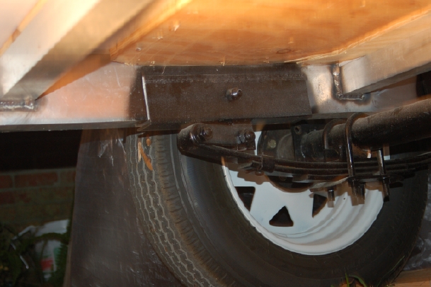

Postby Lynn Coleman » Tue Mar 27, 2007 12:08 am
Phil & Ningning wrote:Front and back?
If you are not sure, you should take it to a qualified trailer builder to sort it out for you.
Good luck!
LOL the guy who built the frame supposedly was one.
Here's a pic of the forward connection.
Lynn

Postby Nitetimes » Tue Mar 27, 2007 12:12 am
Well your front hanger is right but I kinda think he cheesed on the bolts in the angle. I would have at least put one at either end of it. I think eventually that setup will let the angle rock and wear the aluminum.
BTW that spring shouldn't be that flat, that is due to the shackle up against the frame pulling it tight.
