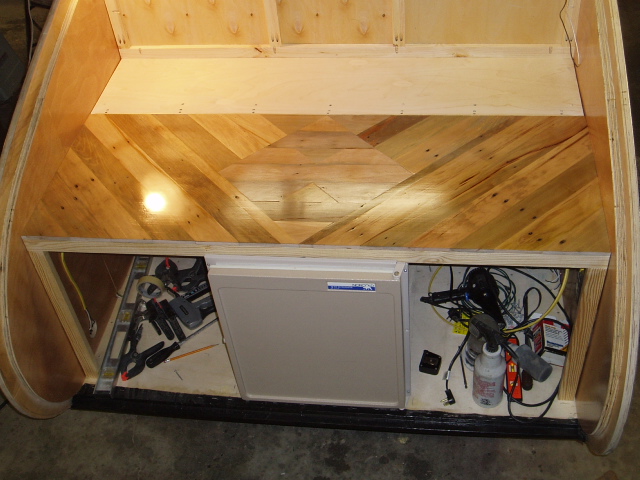

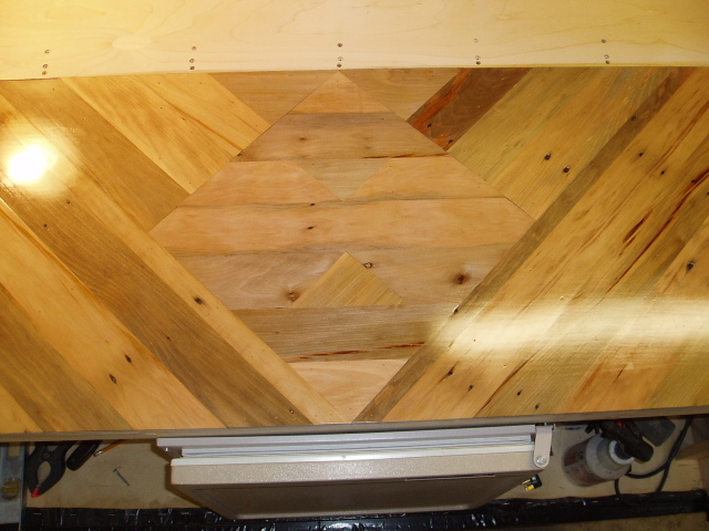

The other day I was out looking at my TD and thinking of what I was going to make the counter top out of. So I went upstairs in the in my garage and started looking through the lumber I have and I ran a cross some old popular I had from some pallets I had taken apart a couple of years ago. I pulled one of the 3/4" X 3" boards out ran it through the joiner and then the plainer down to 1/2" cut it to fit layed it out on to 1/2" baltic birch and this is what I ended up three days later after sanding and four coats of clear. kind of rustic

:beautiful: :woohoo: Good Job Legend!
Great use of free materials.
