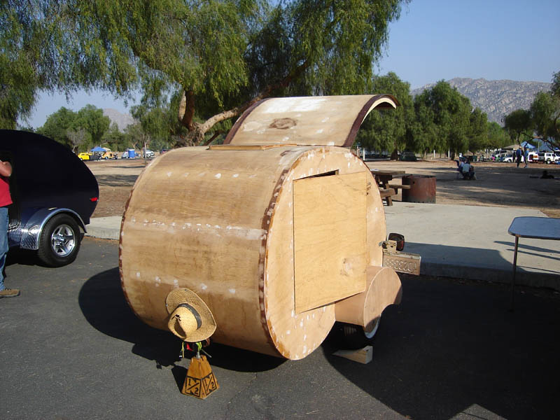

Postby reiltear » Sun Apr 15, 2007 11:58 pm
Hi Kristi!
It's a very creative teardrop you have built. I also like the very artistic finsh it's going to have.
I'm sure you are aware of Roly Nelson's "1/4 Stacker", but in case you missed it:
http://tnttt.com/viewto ... 1+4+nelson
Here it is at the Lake Perris gathering:
With a galley:
