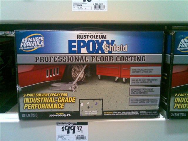

:dead: Sorry if this was covered elsewhere!
OK I did a Search for Epoxy paint and epoxy & garage and found a few post in regards to people going to try out these products but I have not been able to find any results? :x So what was the Verdict? I'm not interested in the waterbased stuff or the 1-step products but the 2 part Solvent Based product
http://www.rustoleum.com/product.asp?frm_product_id=59&SBL=1
I know what the instructions say but has anyone tried it?
