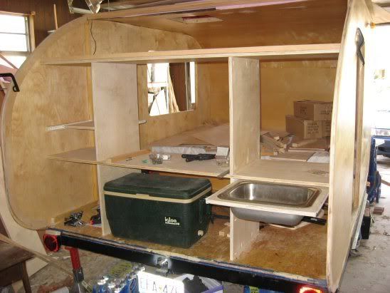

I have my sink in temporarily and realized I really should make it go in the cabin and the galley. I haven't been able to find a slider that will allow that.

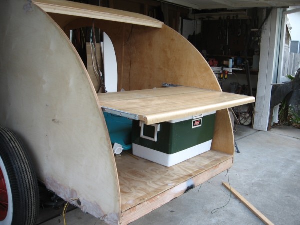

Thanks Martha, I will check around and see if I can find some table supports. What I have on there right now is a Medium weight, under (Euro) drawer slide. It will hold up to 75 pounds out that far. Over kill but I like the way it installs.
I used the same for the TV on the other side. :thumbsup:

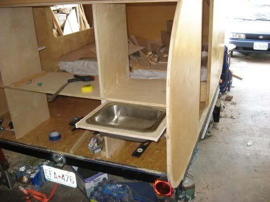

It seems I can't find a two way with full extension and to get the table all the way out on the cabin side I need to add 3 inches to the board, which I can't do because I had Lowes cut the sheet to 18" for the counters. The table support seems to be the only real option and I'd still need to recut the board. Backin up is what I do best. ;)
Adding an extra like Jim suggested means cutting and finding a way to rejoin with rollers on both ends. :? Sounded good. Might still work.

I think I finally understood. Logistically That might work. It will be a tight squeeze but I am going to try it.

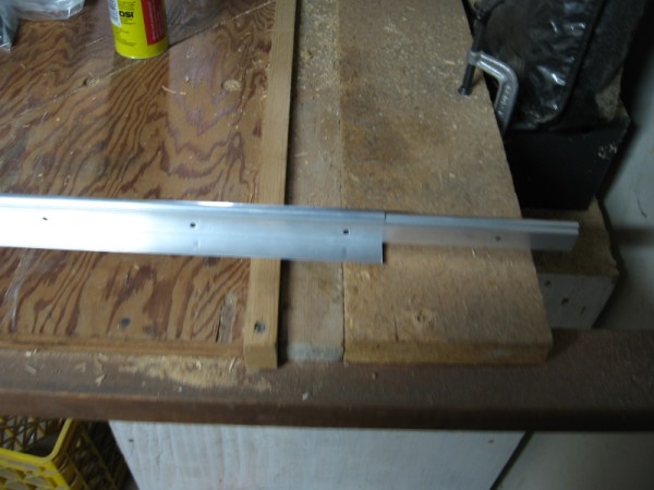

Most brackets need 1/2" on each side for clearance. As you can see I barely have an inch to play with. Maybe turn the sink around and have it stick out into the galley when not in use.
This is the bracket that holds the sink. The long part is always under the cabinet. I need to see if I can get full extensions or cut a new board with an extra 3 inches on the other end. I will go to HD and get a 1/4 sheet today and try it.
Good ideas are worth pursuing. First I am going to hit the real hardware store and see if they have full extension slides. That will save getting a new board. :?
