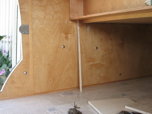

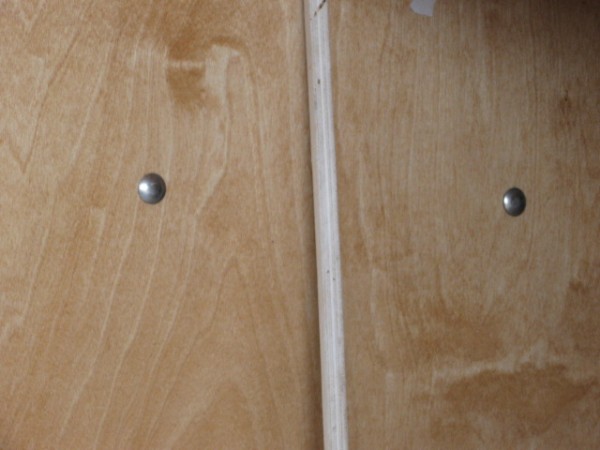

We used carriage bolts, because the head is pretty smooth and not too ugly. We used stainless steel, size 5/16 of an inch, not quite sure what is equal in metric.
Others probably do it differently, I don't know???
First is picture of bolt, a little fuzzy but I think you can get idea.
Next is where you see the 4 bolt heads, that part of our teardrop is open at bottom.
Next is a little closer picture of 2 bolt heads

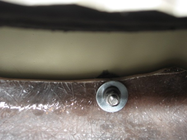

Last picture is taken inside fender of end of bolt with nut and washer.
My husband put a very little rubber spacer between fender and teardrop.
Hope this helps you Heikki. Also if you check my album, you can see my newest pictures. We have taken it on a test drive. You can see the Ford fenders, white wall tires and everything. :lol:

Wow Martha you folks sure have done a very nice job on your tear as well. :thumbsup: Im going to see if I can find some caps to put on the bolt heads after they are in place.. I can countersink the bolt in a lil and place a mahogany type cap to cover the bolts up but it looks like yours are not bad at all right from the start..

We used the larger fender washers too like Tim & Lori.
