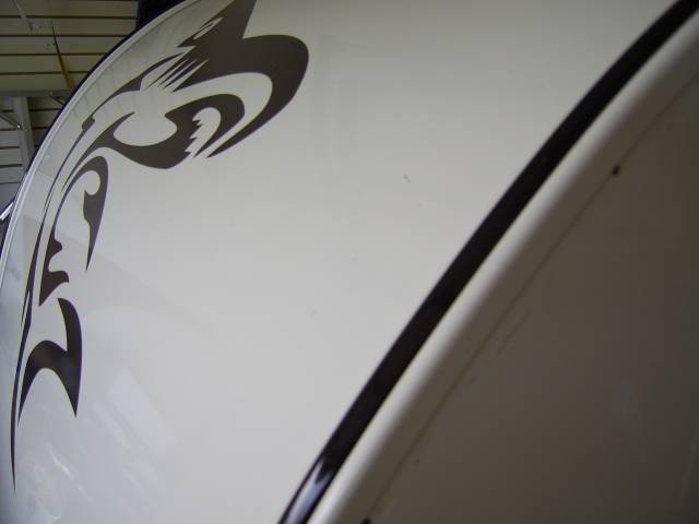

i removed the alum angle, cleaned all the calk up, and replaced with insert trim molding. this stuff rocks, highly recomend. no annelaing, molded perfect. take a look.

Postby s4son » Mon Apr 30, 2007 1:51 pm
I used mill finished trim with black insert. Anyway, it bent to the curve very easily, no anneling necessary. It's a softer aluminum then the angle you get at HD.

Postby diverguy » Mon Apr 30, 2007 2:01 pm
thanks scott. any advice is welome. this stuff was a little expensive. however i was able to only buy what i needed. so i really dont want to mess it up. plus i got all they had.

Postby madjack » Mon Apr 30, 2007 2:02 pm
DG, that stuff is "dead soft" and should not require annealing...take your time and it should go right around the curve..

Postby diverguy » Tue May 01, 2007 7:35 am
madjack wrote:DG, that stuff is "dead soft" and should not require annealing...take your time and it should go right around the curve..
madjack 8)
thanks for the advice MJ. you were right. this stuff bent like butter. i was actually impressed with myself. but that happens alot. LOL.

Postby s4son » Tue May 01, 2007 8:41 am
That really looks good!

Postby Airmad » Tue May 01, 2007 9:32 am
Hey Diverguy. It looks great. Where did you get it, what's it called, and how much does it cost? Thanks. Airmad

Postby diverguy » Tue May 01, 2007 9:53 am
i got it from a local RV dealer. i got all he had about 22 ft. it was $2.00 a foot. it is called insert trim molding. it is an alum extrusion that has a slot where you can insert a vinal trim that covers your screws. i got the yellow pages out and called every RV dealer till i found oune that had some in stock
you can order it from http://all-rite.com/ . i just happen to find it local.
i tell you this stuff was the bomb. it bent so easy with not one single kink to straighten. i installed both sides in about 30 min. had to make a few cuts on it to match other stuff. but it was a breez and gives the camper and more finished look.

Postby Miriam C. » Tue May 01, 2007 10:54 am
:applause: Beautiful look DG. How wide is that on the side edge?

Postby Creamcracker » Tue May 01, 2007 10:57 am
diverguy wrote:i got it from a local RV dealer. i got all he had about 22 ft. it was $2.00 a foot. it is called insert trim molding. it is an alum extrusion that has a slot where you can insert a vinal trim that covers your screws. i got the yellow pages out and called every RV dealer till i found oune that had some in stock
Of those "INsert Moldings" on the ALL-RITE website which one did you use. Give the number if you can.
Thanks
Philip

Postby Mary K » Tue May 01, 2007 11:14 am
That Looks Great!!! And Easy huh???
Thanks for posting this will help a lot folks. :thumbsup:

Postby diverguy » Tue May 01, 2007 11:32 am
i am not sure if what i got came from alrite or not. but my deminsions are 1 1/4 X 3/4. 3/4 on the side and 1 1/4 on top. the top has a 1'' slot for 1'' insert. i believe what i think most people use is the M24 or the M34. madjack probably knows for sure. i just browsed through their pile of stuff till i found what i thought would work.

Postby Creamcracker » Tue May 01, 2007 11:45 am
diverguy wrote:i am not sure if what i got came from alrite or not. but my deminsions are 1 1/4 X 3/4. 3/4 on the side and 1 1/4 on top. the top has a 1'' slot for 1'' insert. i believe what i think most people use is the M24 or the M34. madjack probably knows for sure. i just browsed through their pile of stuff till i found what i thought would work.
Many thanks -- you've confirmed what I had tentatively identified.
Great look on the TD by the way.

Postby Podunkfla » Tue May 01, 2007 11:47 am
It sure makes for a nice clean install... I like it. :thumbsup:

Postby Miriam C. » Tue May 01, 2007 12:01 pm
:thinking: wonder if they make it wider on the side. :thinking: :twisted:
