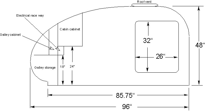

Yeah, I like the Benroy Plans and still have them printed out from when i was originally going to build one. I am just terrible at trying to take the layout from the Benroy and figuring where and how I should set it up in my profile.
Hmmmmmm. Maybe I could lay the Beroy Plans on top of my drawn profile and study it that way. I am a VERY visual person and need something definate to go on. UGggggggggg!!! Lord of Teardrops, please help pitiful me!
I plan on using a queen sized mattress which is listed at 78" length.....Should I install my bulkhead like 80" from the front???? That would leave roughly 4 3/4" of flat floor before the floor starts to curve up. I was going to have a thin storage area accessible from the galley where you pull open part of the countertop to access the small compartment...Does this make sense?
I wonder if a 20" tall bulkhead wall installed 80" from the front will be a good place to start????? Hmmmmmmm just wondering if this could create any problems for the rest of the build.
If I put in a bulkhead, what is the best way??? Frame it or just cut a 3/4" thick plywood to size and screw into it from the outside???? Is 3/4 plywood too thin to drive screws into the edges???? Will I crack it or get tear-out? I plan on Gorilla Gluing the bulk head wall just need to figure the rest of this confusing crap out.
